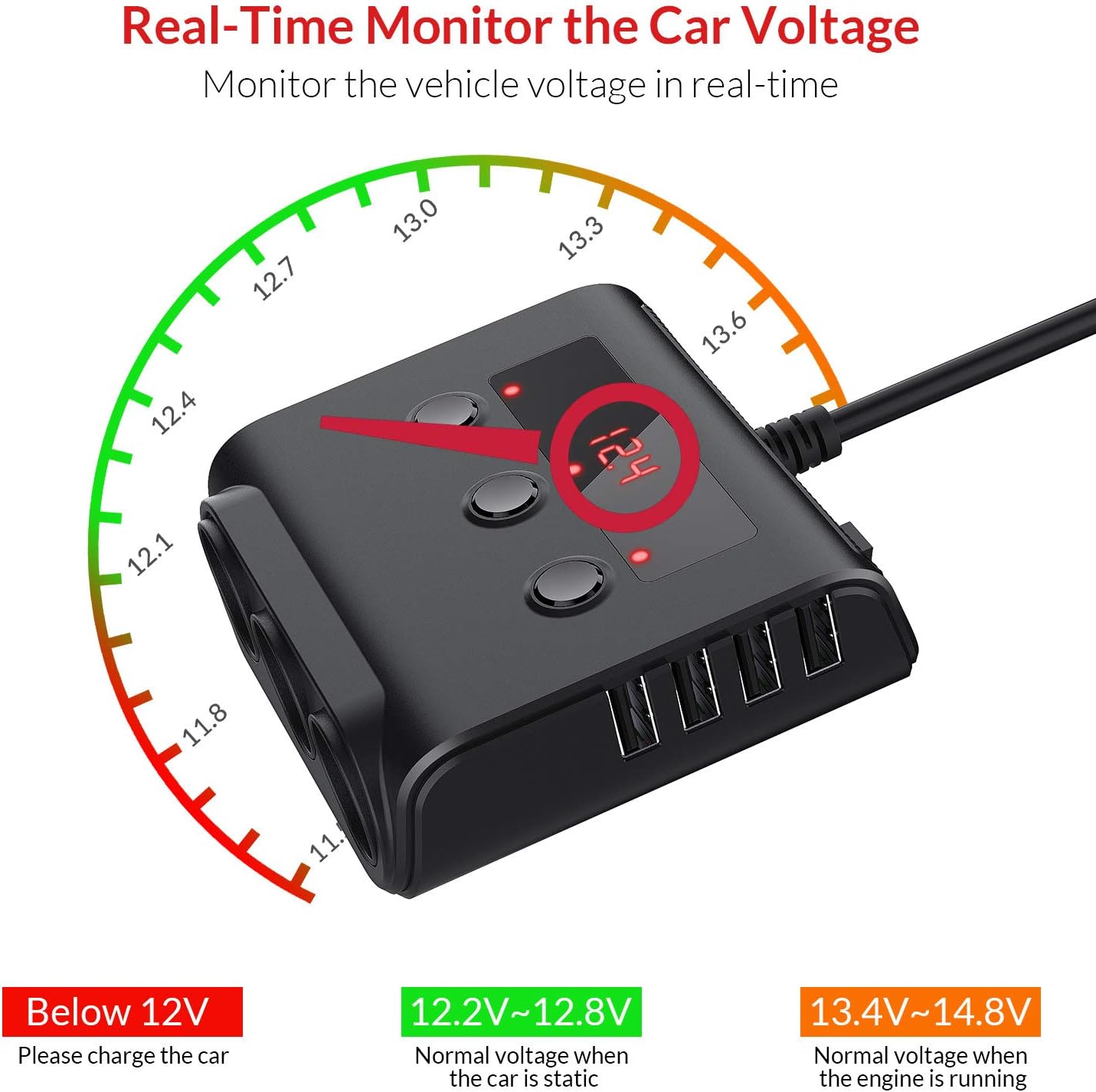

I would recommend getting a 12 V plug adapter displaying the battery voltage to check the voltage and the charge of the battery.
