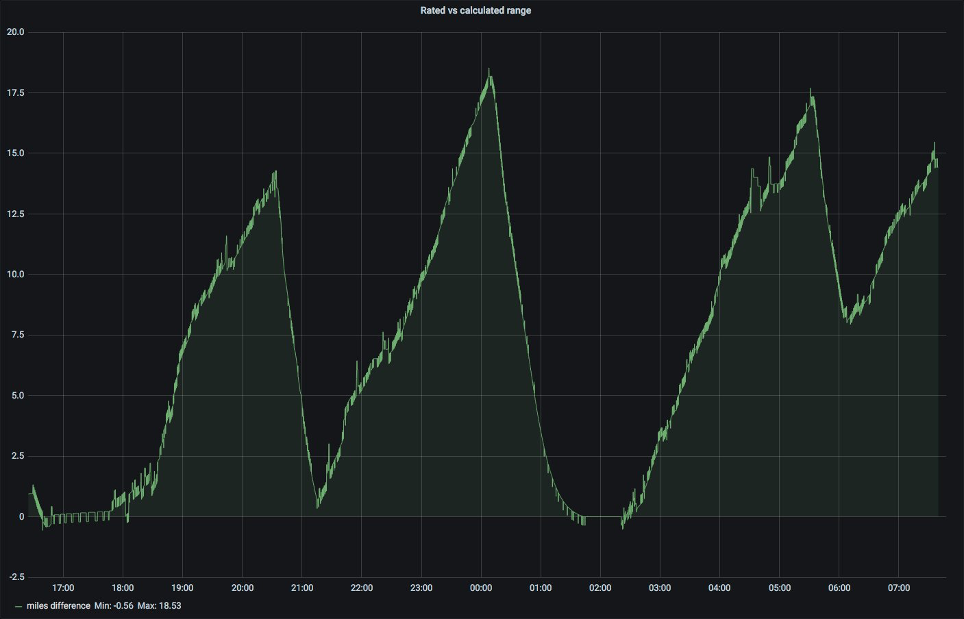

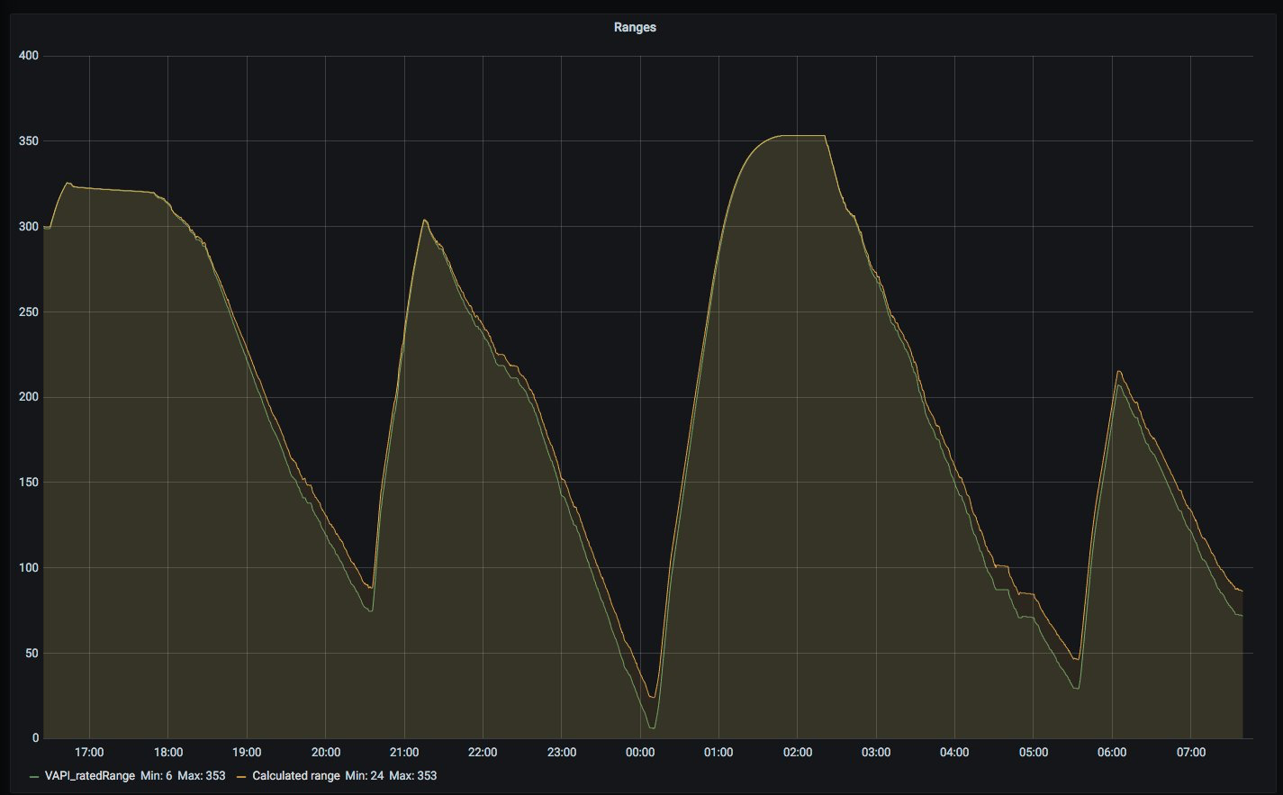

verygreen
Curious member
Jan 16, 2017
2,900
11,263
TN
We know the battery pack version changed so something changed there, but there must be more changes also. Do we know the version numbers on the motors?
the battery got beefier better cooled lines so it can now do 250kW charging, which probably neans it can accept more regen.
Now there were new pm motors showing I think, but it's unclear if they would also be necessary or if it would be just a firmware update to the existing ones.
It's finally safe to drive to 0%?
I never tried to drive below 0%, but I noticed that even when you have 2 miles left there's no more drastic power reduction, just a bit. And internal code confirms 5+kwH usable left. I posted a tweet about these findings but of course with twitter down it cannot be found anymore. (I was told this does not apply to older batteries like 85kWh packs)
found these pictures below in cache (note they are using miles not energy remaining but it was same effect on reported SoC)
Reactions: Battpower
