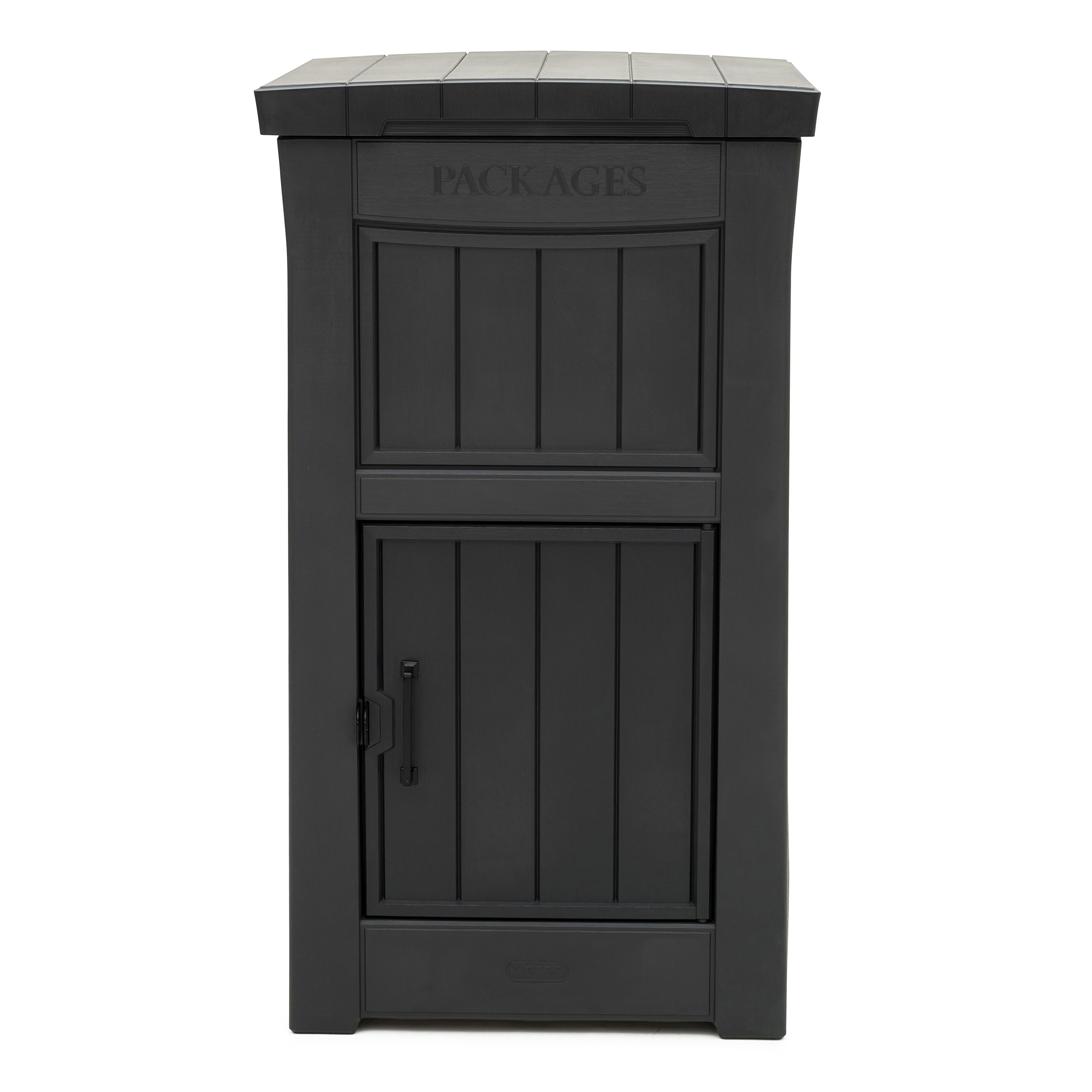

I love the look of the A2, but its too expensive for me.
I was planning on surrounding whichever charger I get with something like below (£95). Just need to cut a whole at the back, and a small gap in the top for the wire to come out of when charging:
keter-parcel-plastic-garden-storage-box~7290112633064_01c_bq
