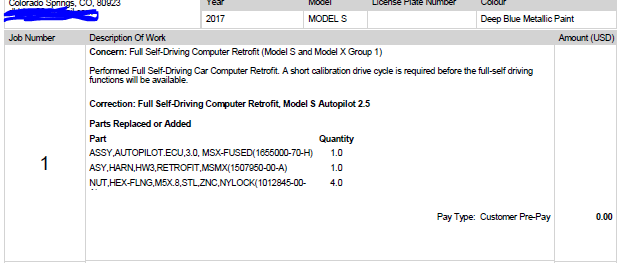

They finished my upgrade after hours today. Here's my invoice. Interested if it makes a difference that they stated it was a AP2.5 to 3.0 upgrade even though I clearly own an AP2.0 car. I guess I'll find out if it works tomorrow.
c0smicdirt
Apr 5, 2020
50
40
New Jersey
No. My invoice said the same. They just used the parts from the 2.5 kit.
