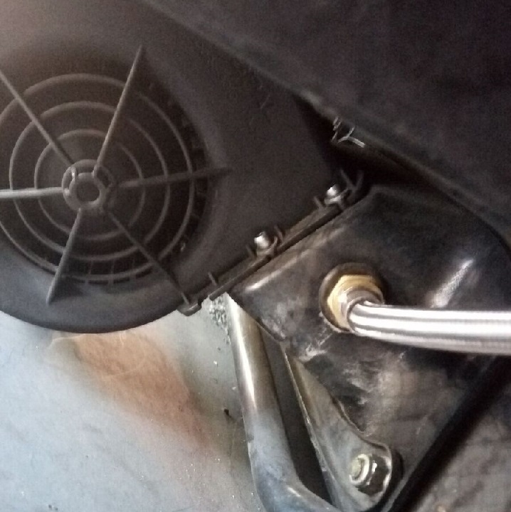

    Static test of CO2 cooling parts...
    Tank was full so liquid draw when horizontal. Plan is to mount the tank upside down.
    Flow rate is 2.5-2.6lbs/minute so 85% usable off a 20lb tank is about 6m30s of run time.
  4. nick
    nick Member
    May 22, 2012
    155
    Installed and track tested...

  9. nick
    nick Member
    May 22, 2012
    155
    The first session I did the warmup lap without cooling, then 4 laps before the CO2 ran out.
    The next two sessions the motor quickly overheated with gas left over - discovered the nozzle was blocked from small chunks of the teflon tape used on the threads.
    The last three sessions the CO2 cooling worked - the battery overheated before the motor. The car has air-con cooling for the battery pack but it only seems to use it for a short time to get the temp just below the overheat threshold.
    If I could force the air-con battery cooling to run for the full 40 minutes between sessions the battery might cool down enough to do the 4 laps the CO2 can support.
    Could easily run two tanks of CO2 together to double the CO2 run time... then we would know how many laps the battery can do when cold and determine if it is worth it.
