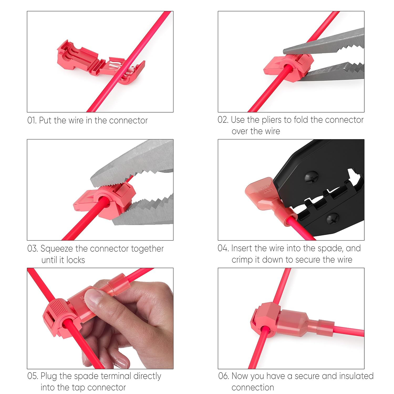

Thanks for the guide. I just fitted my 750S over the weekend. Only thing I would add is in the UK there is no spare power supply in the panel. In the UK that connector is connected to I think Ultrasonic sensors for the Car Alarm. After trying several other options I ended up running the power lead along with the Coax cable to the rear of the car and tapped into the 12v supply for the boot (or trunk!) opener.

I tapped into the red with the gray stripe, and the black next to it on the tailgate supply.
12v constant in rear trunk
This thread gives you most of the information. I just used a couple of scotch locks to tap in and then put in a inline fuse and connected up to the camera.
