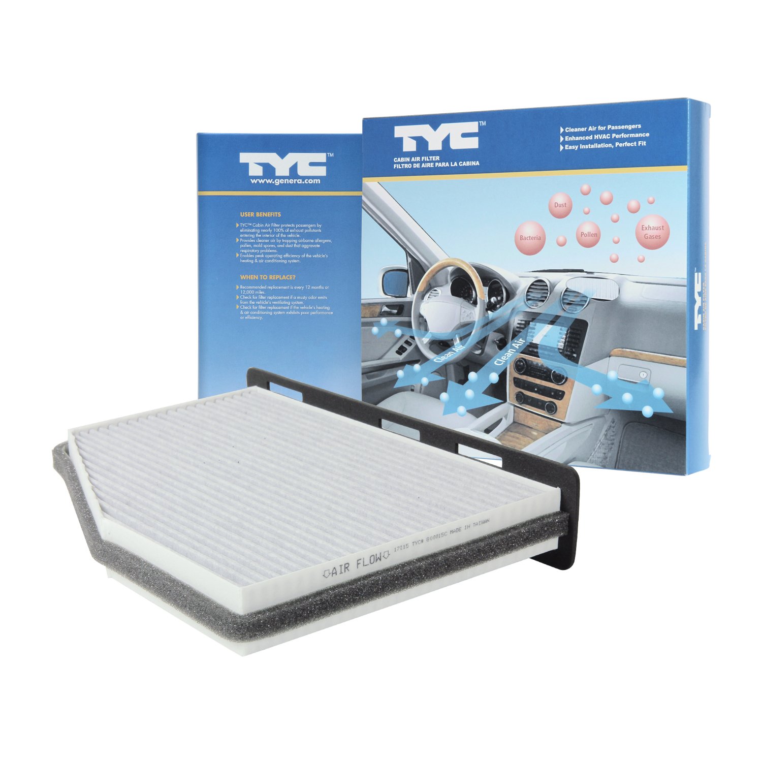

I just did it last night so I have don't have enough "data" to see if it helped with actually filtering the air instead of letting it go right around the edges and corners. It's weird that Tesla made a decision to go all out with their HEPA filter on the new cars after leaving such a poor solution in place in the older cars for so long and not having an updated filter with small foam edge to make a tighter seal like some other brands as seen below for a non-tesla car:
