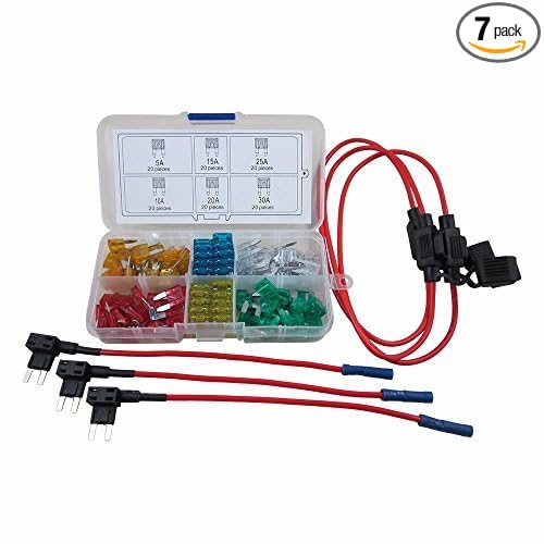

Definitely get a smaller fuse! A 15A fuse, if there's a short, it could quickly burn up some wiring or other components before a 15A fuse blows.
Just get something like this for $12:
https://www.amazon.com/DIGITEN-Assorted-Inline-circuit-Adapter/dp/B01G8HUTCW
