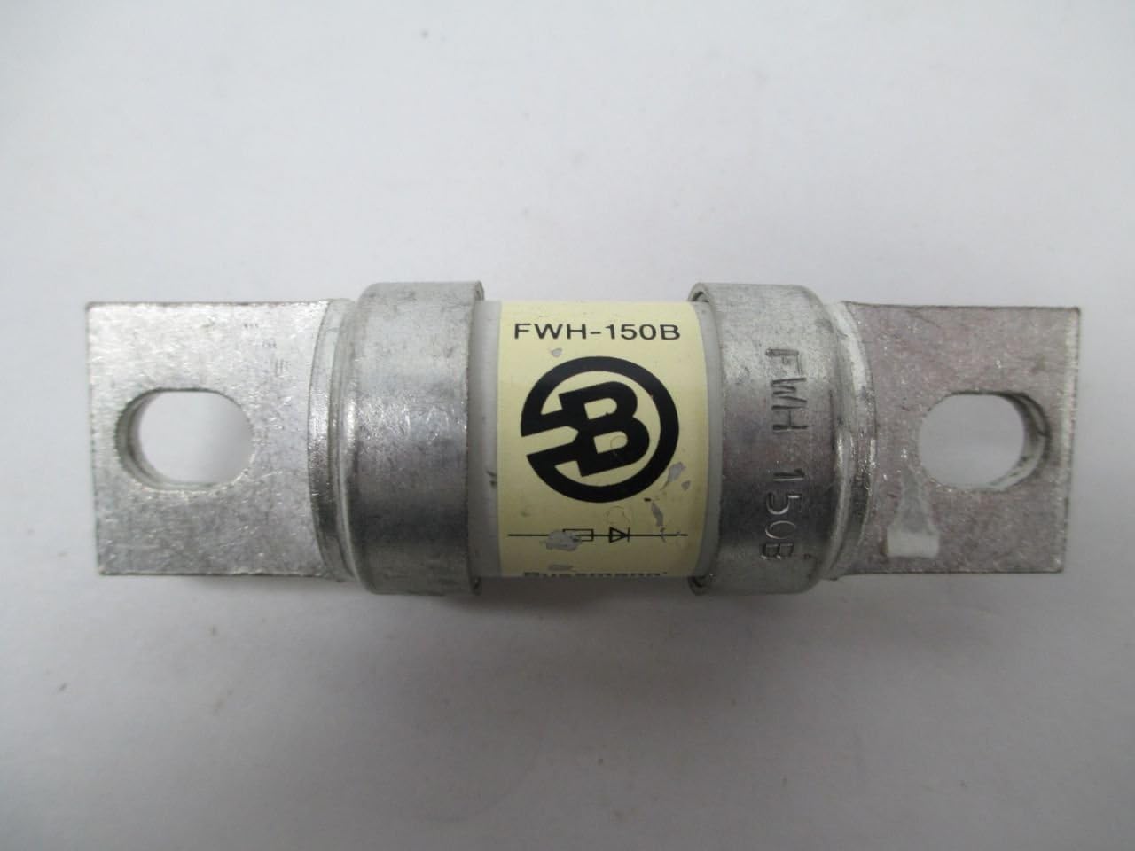

    To close this out, cause was blown inline fuses. Repair cost $1014.95 + tax.
    Does anyone know where to buy these 500V '2004266' fuses for the next time this happens?

    If the fuses in question are the ones on the AC input wires coming from the charge port, then the 2004266 number must be a Tesla part number. The actual fuse part number is FWH-150B, made by Eaton Bussmann. It's 500V 150A, fast acting. When one of mine blew I was able to buy one off the shelf at Grainger for $100 to get back in operation. But since this was the second instance on my car (the first time was back in 2009), I decided to carry spares. I bought two on Amazon for about $40 each.[​IMG]
    Your car appears to be a 2.5, so replacement of these fuses is easy. They are accessed under a little panel on the right end of the PEM. My car is a 1.5 which requires taking off the whole top cover with a zillion screws some of which are hard to access because of the sloped edge adjacent to the trunk tub.

    Thank you! Yes, your specs appear to line up with the part description:

    Just search FWH-150B on ebay, they are very common abs cheap.
