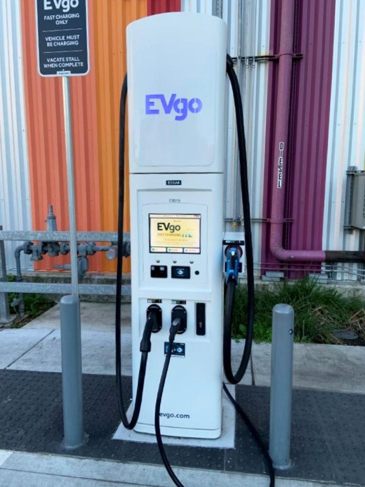

The EVgo solution is just a repackaged Tesla CHAdeMO adapter bolted to the side of an ABB charger. All the ABB chargers deployed by EVgo so far are 50kW 125A Max units. EVgo have deployed higher power chargers made by BTC, but EVgo have not settled on the Tesla adapter mounting for those yet. In any case, you will still be limited by the 125A max rating of the Tesla CHAdeMO adapter, even if the charger can do more. You can see in the picture below that the CHAdeMO cable must be plugged in at the front of the accessory box and the Tesla cable comes out of the back of that box. Plugshare - Whole Foods Market St. SF
Thing is that the circuitry that does the handshaking translation between the charger and car would be the same regardless of power level. For a fixed installation such as this one, EVgo could easily spec a heavier duty DC power pathway than the regular portable off-the-shelf CHAdeMO adapter offers. As can be seen in the photo, the EVgo CHAdeMO receptacle and Tesla-side cabling/plug are already different than the portable CHAdeMO adapter - no doubt with Teslas help. So for the BTC chargers you mention, it would be neat if they could get them to the 100 kW level. Might only require a minor firmware mod to change max power level.
Other pictures show the red molding color of the Tesla adapter present in the EVgo CHAdeMO receptacle. So, I'm sure most of the guts are the same. There was a rumor that Tesla was testing high power CHAdeMO in Japan. The rumor came from someone that was at a CHAdeMO interoperability event where prototype chargers and vehicles are tested. I would imagine that any EVgo program to support higher power through CHAdeMO for Tesla vehicles would leverage that effort. At some point, actively cooled CHAdeMO connectors will be a thing, but until then, 200A (80kW) should be possible. I have to wonder whether Tesla has any motivation to help charger manufacturers like ABB, BTC, and ChargePoint provide native Tesla DC charging in North America without this kind of adapter kludge. It was reported that the new ChargePoint Express 250 units can support a third cable. It would be interesting to see SC V2 speeds on Tesla vehicles from these new ChargePoint units that can be paired or even the Plus system that can be arrayed with the Power Cube.
