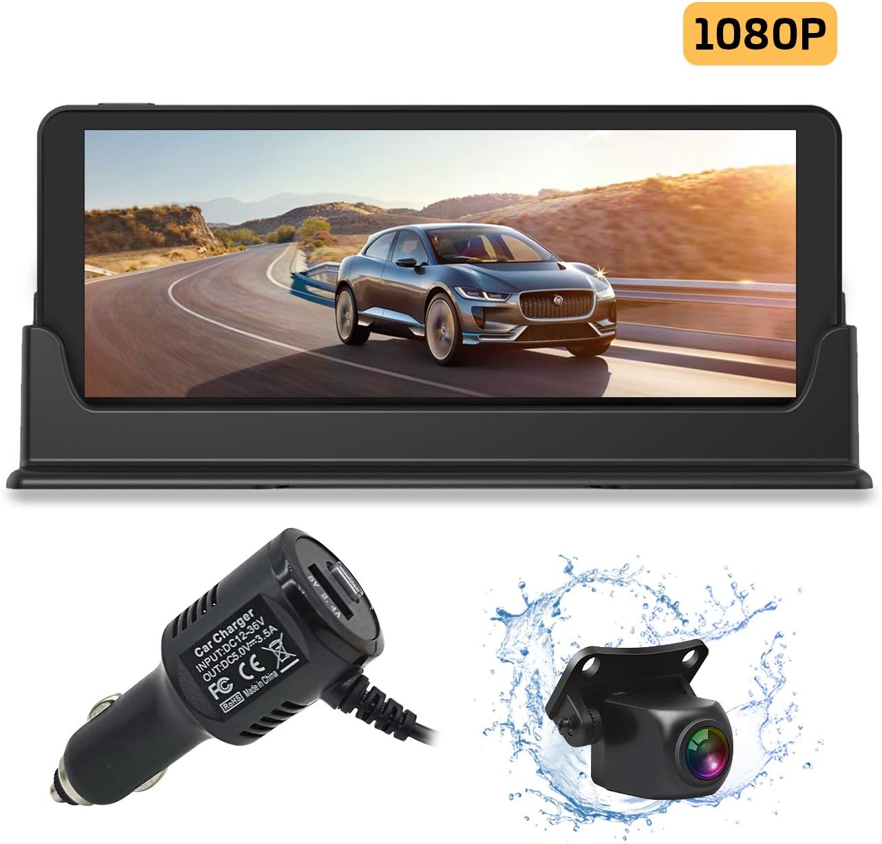

I would recommend this 1080P HD Camera with 7 inch Monitor
- The 1280 x 480 quality of the image is similar to what you get with a front smartphone camera.
- I installed previously the wireless camera with solar panel from Costco recommended earlier but it disconnected constantly.
- If you have a front license plate, you can install this camera below the license plate, so it is not noticeable.
- If you don't have a front license plate, you can install this camera inside the front grill, so it is not noticeable.
- I have this camera for more than six months without any problem.
- The image is very sharp compared to typical backup cameras.
