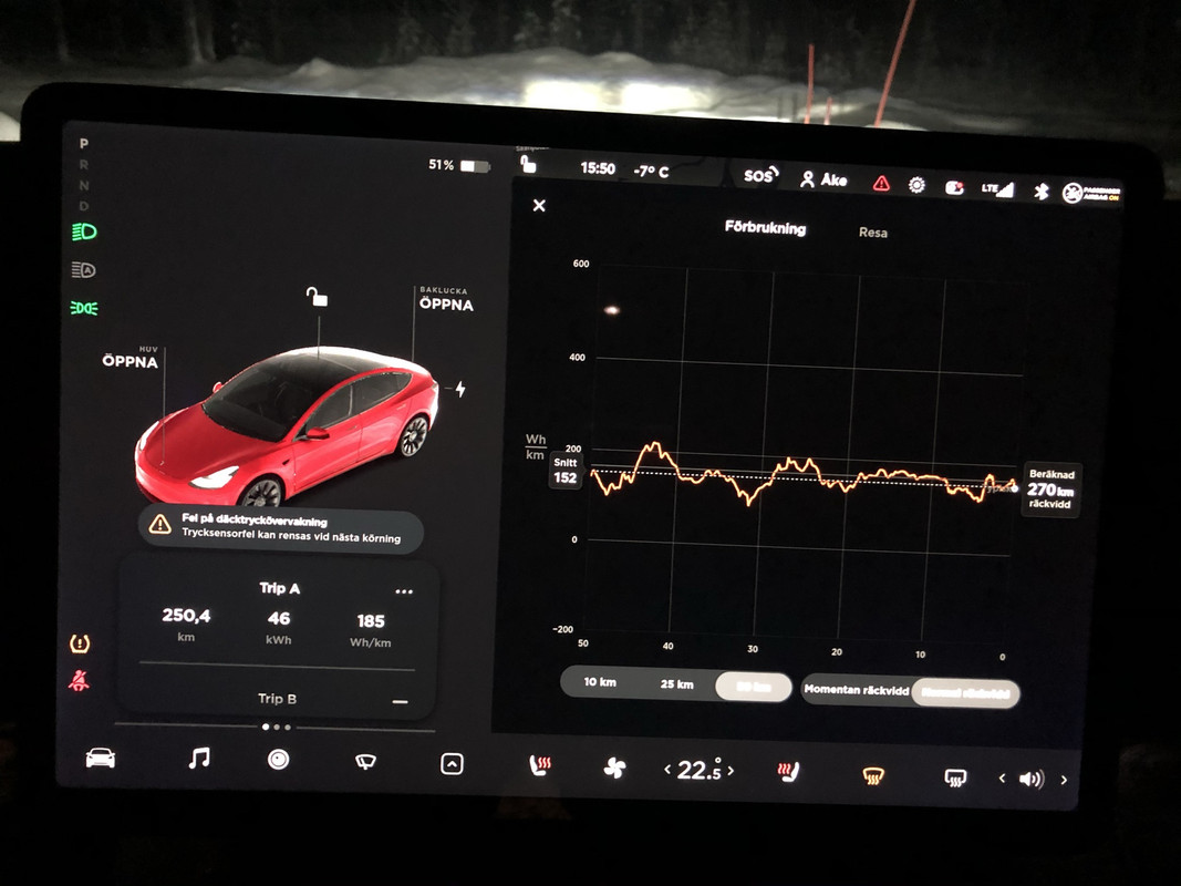

So is there a simple (or complicated?) way for us 2021 LR owners to know if our cars have an LG or Panasonic battery? I'd like to know out of curiosity :).
-Get Scan My Tesla( not that cheap). I didnt get it for the battery size but of technical interrest.
-Or check via the Energy app in the car.
Its beat to have a decent charge, perhsps at least 70%. There are others that know this better than me, use the enegy app to see the average cunsumption for 50km( maybe 30miles with miles selected), and look for the range to the right on the same page( do not use momentary range, but the other one, dont remember what its called.)
Then divide that number with the battery % divided by 100( 73% = 0.73)
I have 152wh/km times (use 0.152) range 270km divided by 0.51 gives the value 80.47kwh.
Scan my tesla reported [nominal full pack] 80.6 kwh that same day.
Nominal full pack is the actual kwh that the battery can store according to the BMS.
This way of doing it seems to work ok.
