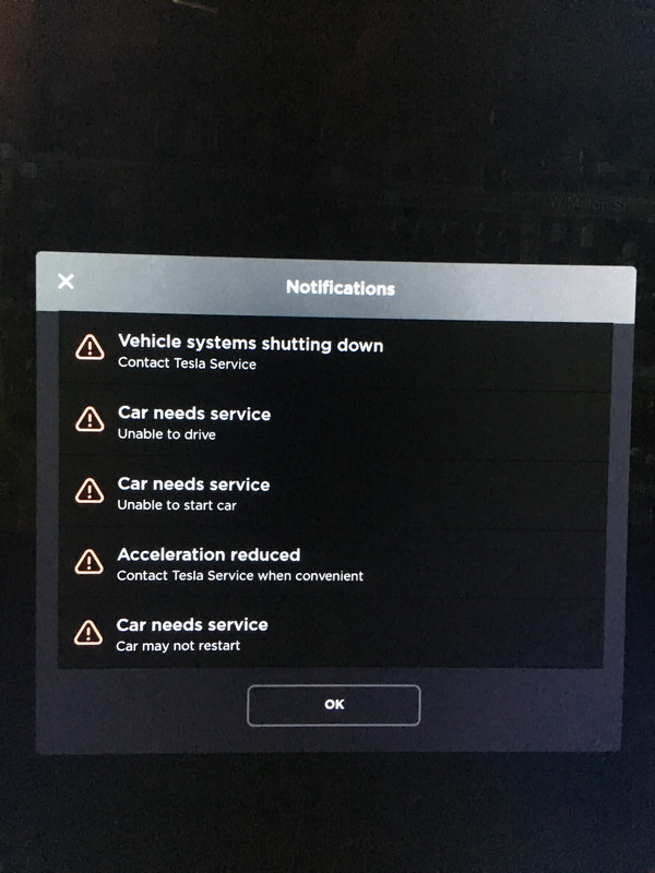

An update to this data point...
I picked my car up from its 4 year service this afternoon. Went back to work, then drove the car home. Grabbed a few things then got in my car so I could meet a friend for dinner and was greeted by this message:
Called the SC and the initial thought is an issue with the main battery. Glad this happened with me being less than 20 miles under 50k instead of over, but it may be covered by the battery warranty anyways.
This now makes 3 instances within 4 years of ownership where I've been unexpectedly left without the services of my car. This has been, by far, the least reliable car I've owned. I still love driving the car. No regrets about the decision to buy. Absolutely pleased with the service center's attempts "customer care". But I can't deny or downplay the fact that it hasn't been up to par on the reliability side.
