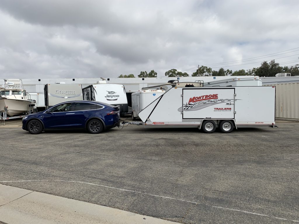

  7. j-rho
    j-rho Member
    May 1, 2018
    65
    San Diego
    Have towed an enclosed race car trailer a lot with a Model X 100D. I expect double the usable range in a tri-motor CT because it start off much bigger and dirtier in the airstream, should be less impacted by the trailer's aero hit.
