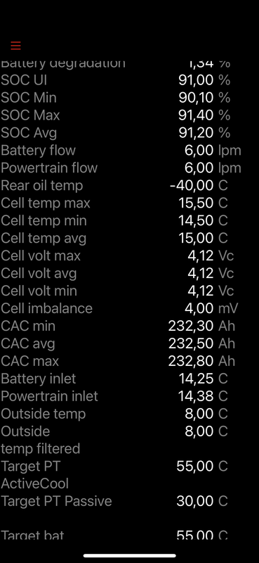

I also have a ’21 M3P with the 82kwh batt.
Charged to 91 the other day for balancing purpose.
SOC 91% and 4.12V/cell. 10 degree C in the garage if it have any input on voltage.
[Edit] found Nominal remaining 73.00kw and SOC 89.66% on another pic from the same time.
BTW, wheres the ODB2 Didnt think there was any so I use the ODB-connector in the middle console.
