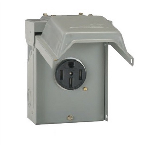

PS I won't comment on the aluminium/copper wire discussion, above, it's a 5 page story. Also, Midwest does make a great metal heavy duty outdoor receptacle U054. The actual receptacle was Cooper, but may have changed in the last few years.
