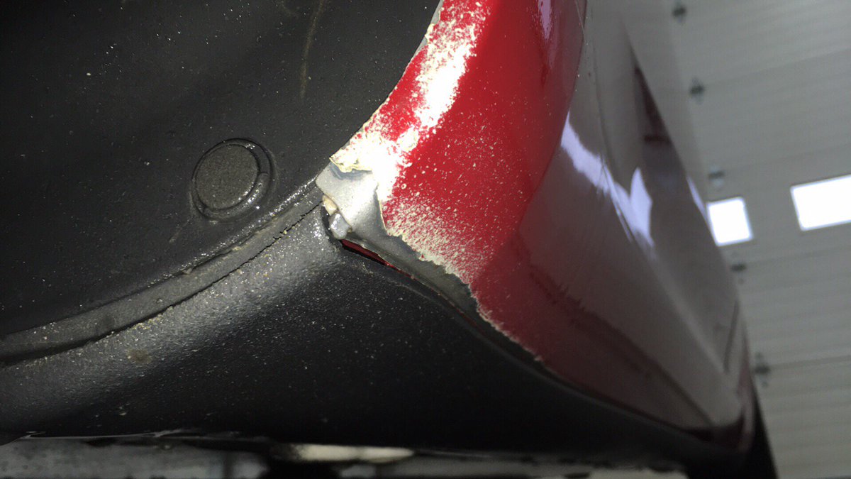

Unfortunately, regardless of paint quality or batch, if you encounter rocks and sand (such as non-city driving or where they add it to the roads) you will have issues along the rocker panels. The car's aerodynamics are such that the vehicle is effectively out of the way of blocking things coming off the tires. With the minor exception of behind the rear wheel, where you can see that my paint was destroyed. This also means that that particulate (dirt, rock, sand, etc) can and does come back against the car body.
I'm far from saying I don't like my M3. If anything, this car is wonderful to drive and fully entertaining when I hit the gas. However, it is NOT going to be able to stand up to winters in any location that uses rock or sand for ice management on the road! Ever. Tesla will tell you it is environmental, the county you live in is going to tell you it is the car problem, etc, etc. With that said, make sure you get a PPF that is thick and self healing. Talk to the person putting the PPF on and make sure they understand what you are trying to protect against.

I don't know whether the paint is soft or not, or whether California regs make a difference or not, or whether water-based is softer or not, but I do know that the car's aero design increases the demands on the exterior.
Rather than a vertical-sided car, like a Prius, which would keep the tires totally within the space of the wheel well, Tesla chose to curve the sides of the car under. Looks nice, but it exposes the underside, rockers and lower door, to any road grit thrown up by the tires. The rear wheel well arch flare, behind the door, also gets exposed to road grit. Then, having underbody panels to smooth the airflow means more grit makes it further back. In a regular car, without underpanels, grit would be hitting all the exposed underbody parts, and falling to the ground, where in the Tesla, all that grit gets redirected along the airflow towards the back.
Then you also have wide tires, and AWD, all contributing to the problem. So, whether paint is an issue, in my mind, doesn't really matter, because I doubt any paint could withstand the amount of road grit abuse due to the design choices made by Tesla, for aesthetics and aerodynamics.

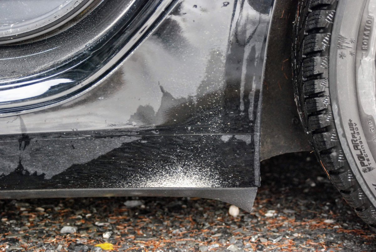

FWIW, I have the road rash issue on my Midnight Silver, AWD LR (purchased in October '18) and it is directly related to a SINGLE trip I took over the Cascade mountains in Oregon back in January. I washed the car before the trip and there was no road rash and washed it on my return and it was significant, especially along the rockers and rear wheel well flares but also on the doors themselves. To address some of the speculation on potential causes here, I didn't have the aero covers on the wheels since I knew I might need to install chains. I wasn't driving aggressively since the road conditions didn't allow it (packed snow and icy surfaces). The roads were sanded over the passes, and in Oregon "sand" means pumice. After determining that the pitting was serious and couldn't be fixed with rubbing compound, ScratchOut or other DIY solutions, I brought the car into Tesla and they agreed to repaint the damaged areas under warranty. Judging by the comments in this thread, it sounds like my experience with Tesla is unique. Also, FWIW, I've driven my Audi A3 over the same roads in the same conditions multiple times and never suffered any damage whatsoever.

It would seeem like some late 2018 and early 2019 Model 3s do have softer paint than usual in cars of this type judging by these images and videos. Those certainly seem unusual results for such new cars. There also seems to be thin paint on some cars.

Most reports are based on road rash but there are also reports that touching by finger could leave more marks than is usual for cars of this kind.
There is a theory that some later 2018 or early 2019 made cars at least have thinner and softer paint than previously and that shows in easier wear on the doors as well as possibly a see-through effect from too little paint in some areas of the car.
