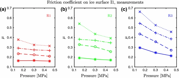

Not a physics professor, but I've played one on TV.
Friction on ice/snow if highly variable - it gets very low (low is bad) close to freezing, as a little pressure will create a water layer that lubricates the sliding. At very cold temperatures the coefficient of friction is higher. It also is speed dependent - higher for no sliding, then drops quickly as the sliding speed increases - so, once it starts moving, hard to stop on its own. Using a common "worst case" friction on ice of 0.1 gives an angle a little less than 6 degrees would allow sliding... The actual friction depends on the tires, the surface, the temperature, etc.
And, somewhat counter-intuitive to your high school physics class, a larger mass has a lower coefficient of friction on ice (it is usually taught as independent of mass), which I believe is due to it being more likely to form a water layer that lubricates sliding. (for the red/green/blue graph - R1, R2, R3 represent 3 different rubber compounds. The upper curves are at -13C. The bottom curves are at -5C.
