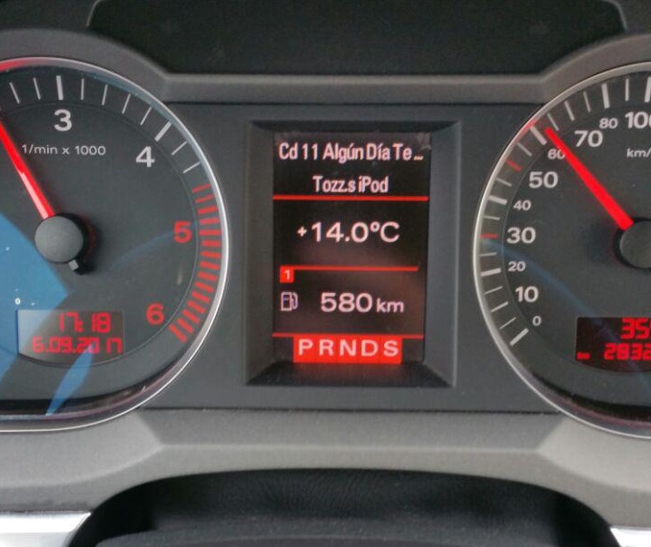

This probably wont help much, but I'm pretty familiar with this symptom. I had it in my Audi:
It turned out the E-Clutch inside the Tiptronic gearbox was broken and this was a very costly repair. This was the last push I needed to order my Model S.
