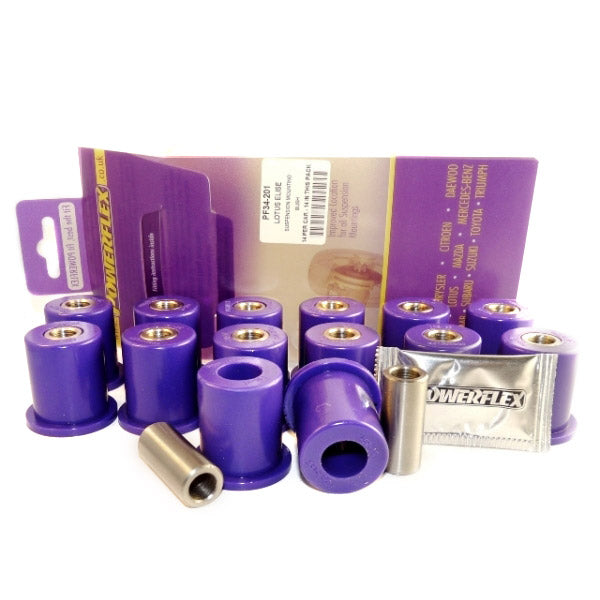

Front needs 8 PF34-201
Rear needs 6 PR32-201 and 2 PF34-202
I got those powerflex from GRP and it came in purple.
Whats the difference between purple vs Black series?
