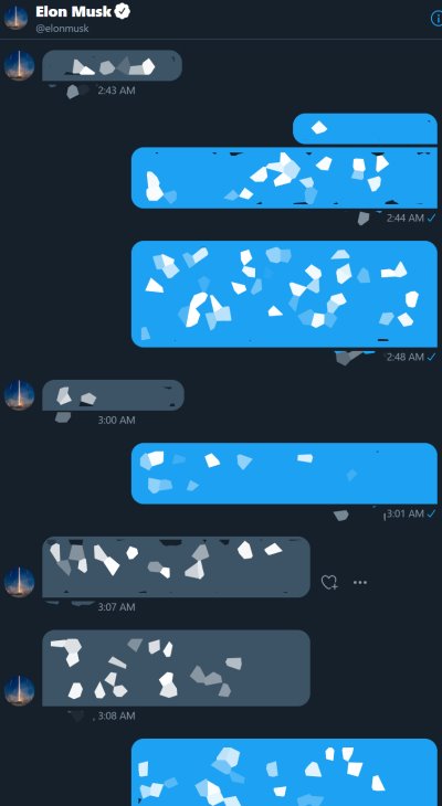

I do have an ongoing DM thread with him on Twitter, and he's generally pretty responsive. He reached out a couple of years ago, and so far all positive developments there. (MCU1 eMMC situation is resolved partly due to these conversations, for example). It's a line of communication I use sparingly, and definitely not one I ever plan to abuse. Just have to not miss 3AM local-time messages. haha
It's a matter of resources. Yeah, I have tons of BMBs, and the knowledge to make it all work. But it's kind of a pointless venture given there is a fix available in the form of software. Why am I going to put a couple of guys on such a task when there's better things they could be doing?
