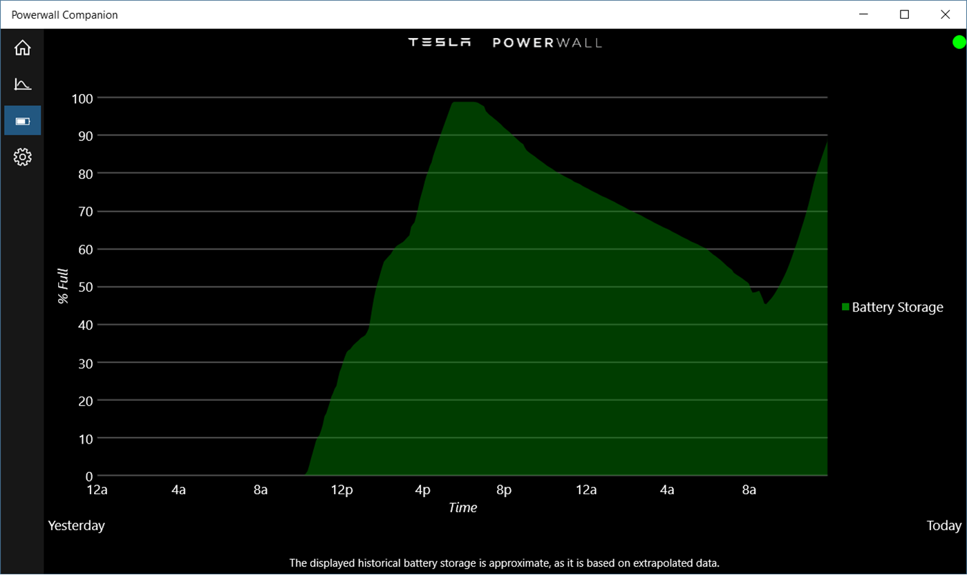

Hi all - I've made an update to the Powerwall Companion Win10 app to include a new feature that is not in the official Tesla app. There's now a graph that shows your battery storage level over the past 2 days. Example below. And before anyone asks for more than 2 days, unfortunately that's as far back as the detailed power info is provided by the API.
Awesome! Thank you for your efforts.
