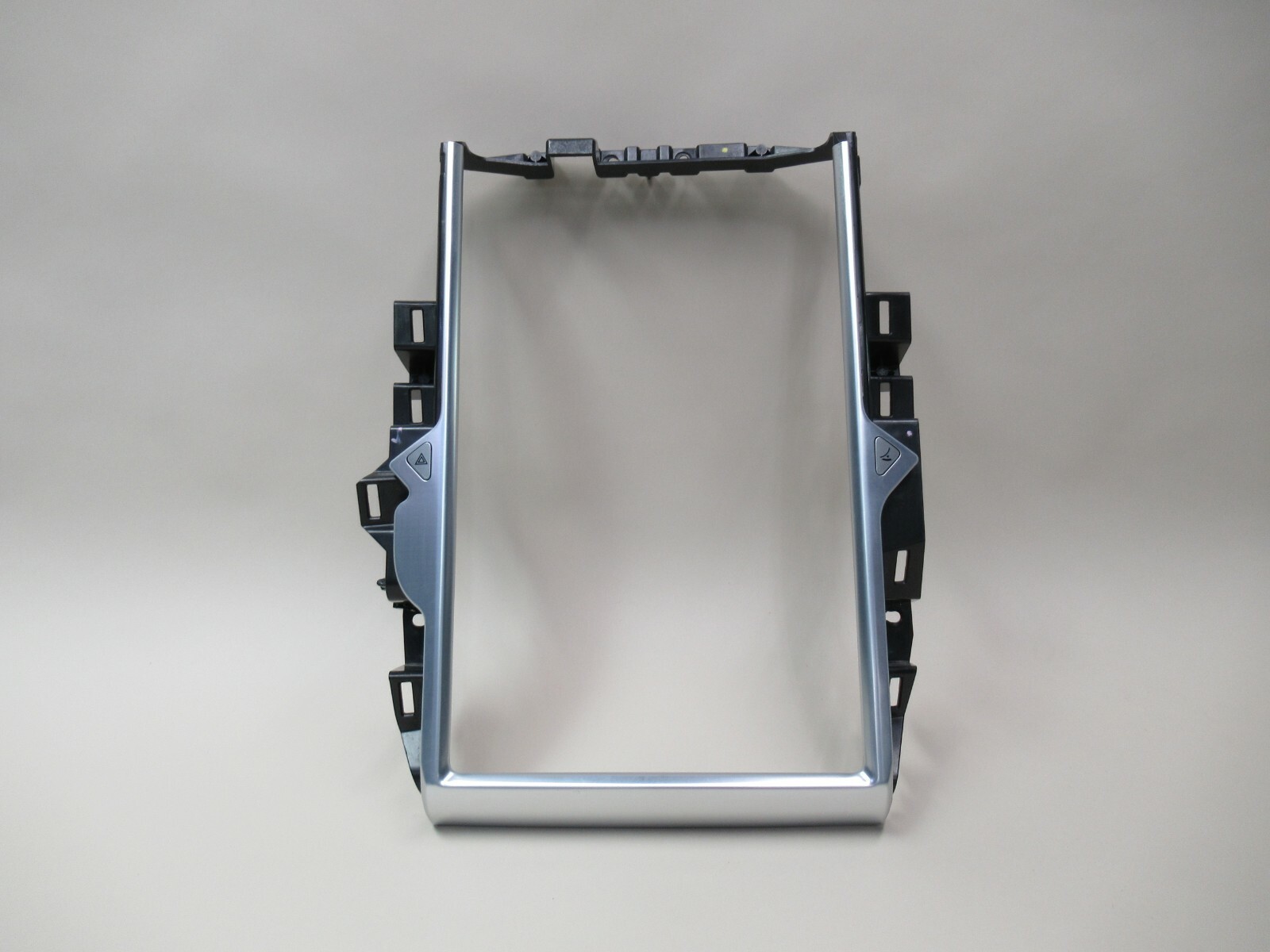

Thanks for the details. Did they replace the MCU Bezel? I didn't know if the bezel came with the new MCU. Mine has a small ding in it. If not, I may order one and have them replace it when they perform the MCU update. I have a Feb 2017 Model S P100D with MCU1 and HW2.0. I have not scheduled since I have not received the email . The silver part # on epc.tesla.com is 1002294-S0-H. The graphite bezel is 1083944-01-B.
Looks like they kept my bezel. It didn't look like it was brand new. The plastic on the new MCU2 was only on the actual display.
