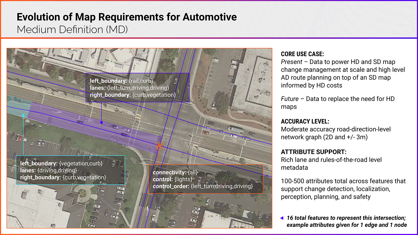

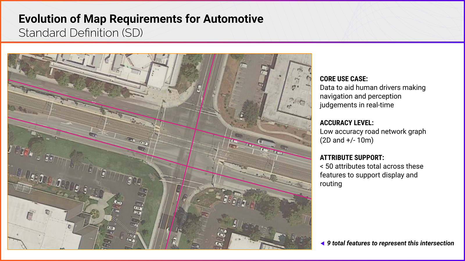

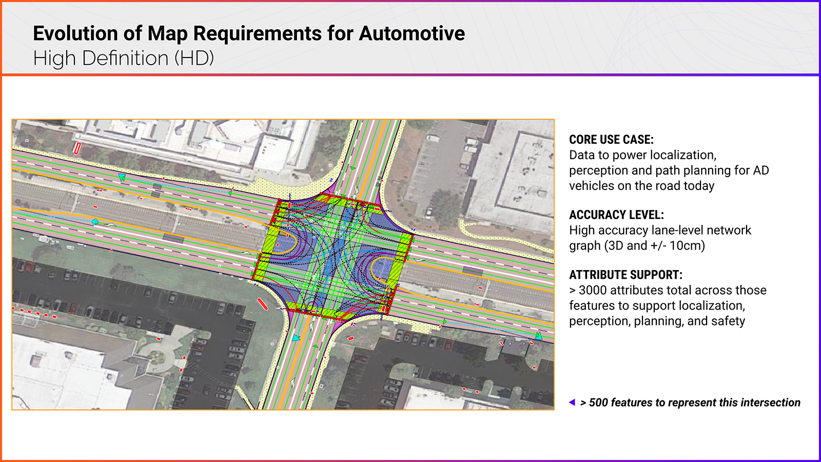

The article also a nice comparison of SD, MD and HD maps:
Standard Definition Maps
Medium Definition Maps
High Definition Maps
