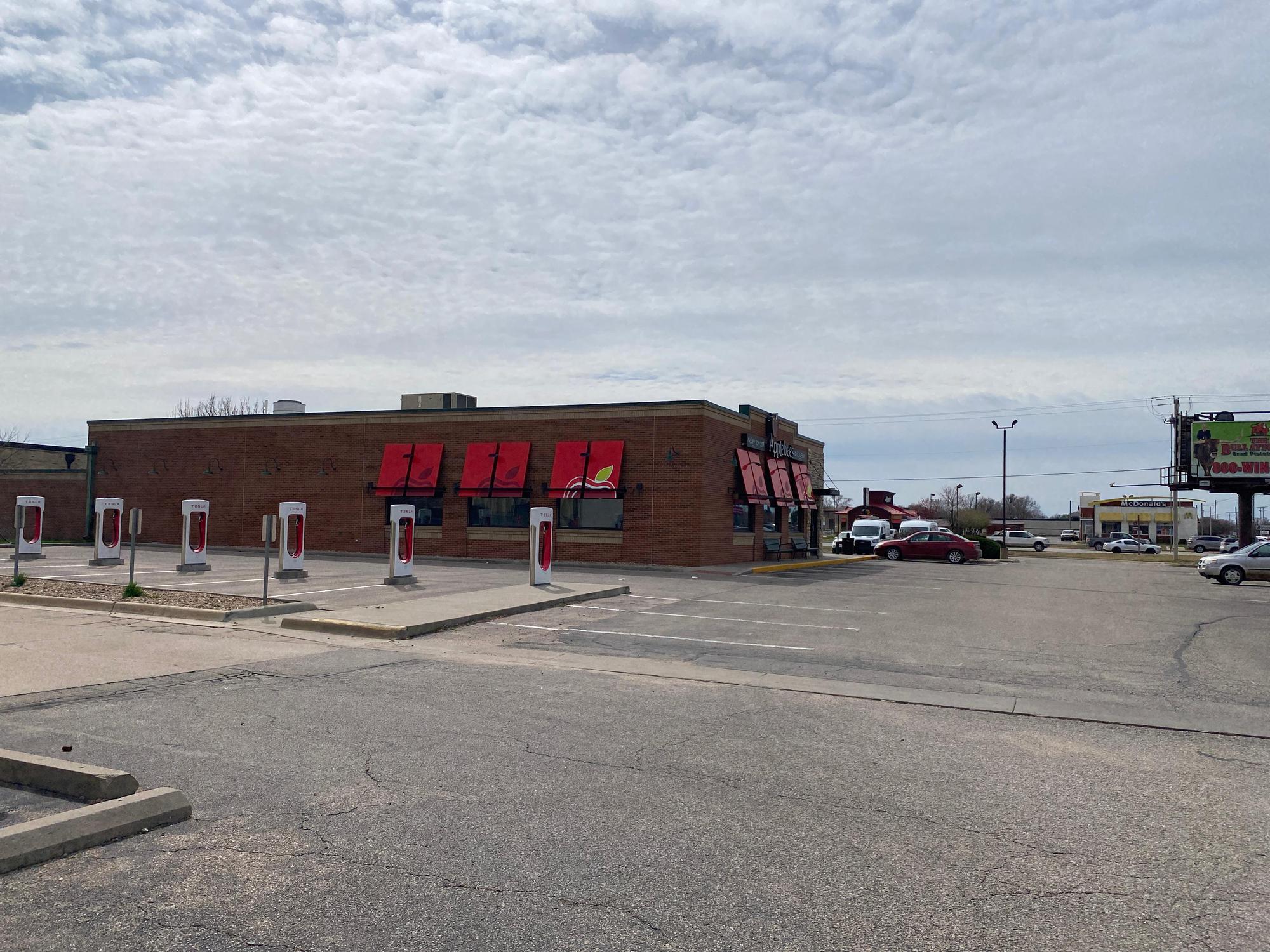

Another thing to consider would be what time of day you're arriving at the various locations and what is near the Superchargers. Wichita is actually in the Applebee's parking lot. So you could just grab a table and camp out while the car charges. Eat a bunch of boneless wings!
