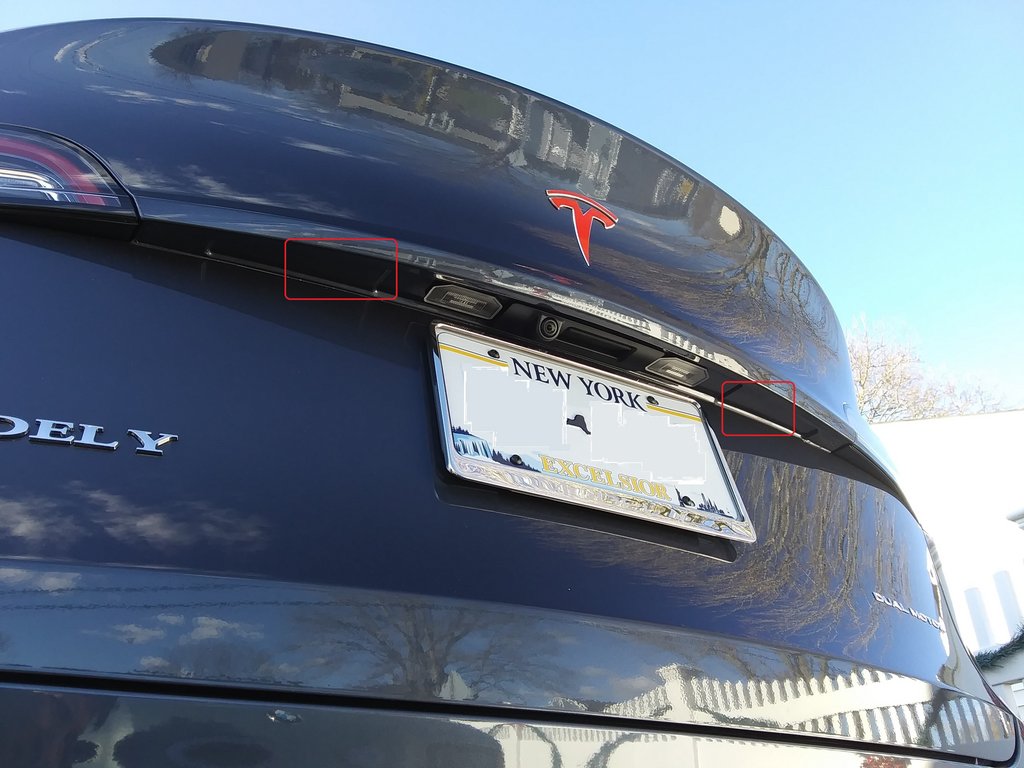

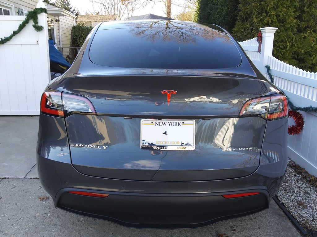

Had one of my kids put the MY in reverse tonight while I stood next to it.. from back there you can instantly identify why the backup illumination is so poor at night unless you ride the brakes. The brake lights are blinding bright, but the backup lights only come from the thin strip of white LEDs circled in the photo below. They are actually fairly bright, but they are not directional or focused so their light just dissipates into the darkness.

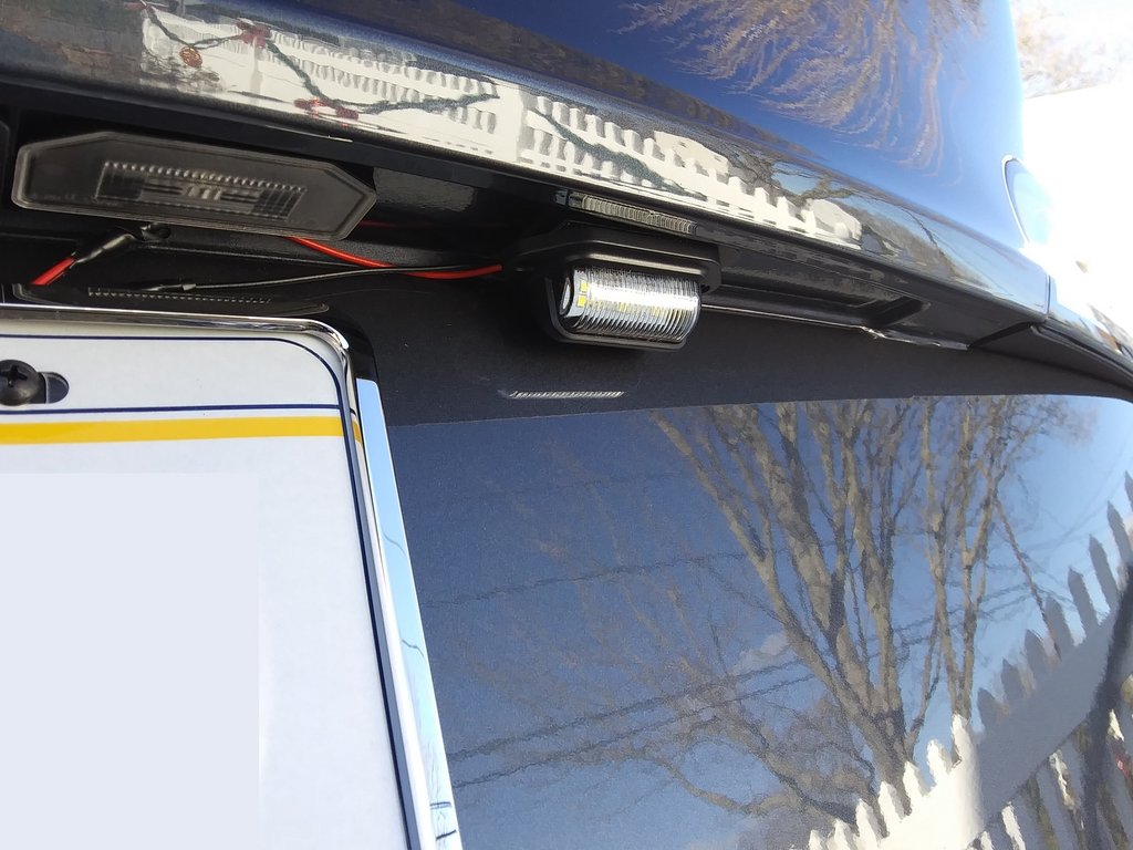

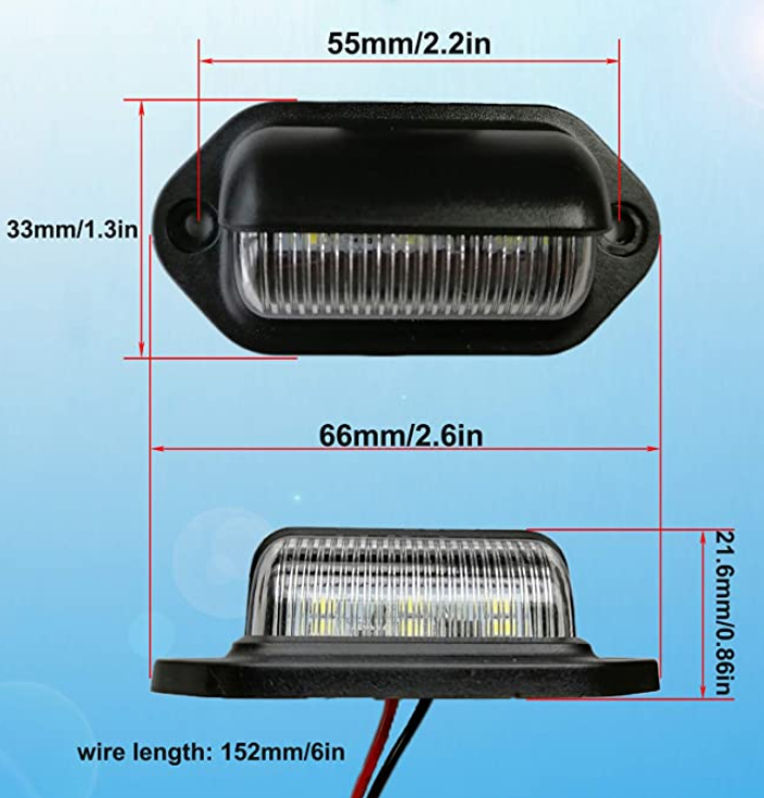

One set of trial lights arrived today ($4.99 for the set of 2), I brought them outside tonight and they seemed pretty bright, will Velcro them in place tomorrow and try them at night.. I expect a big difference....

Thanks @Battpower ... I'll find out tonight. The lights are mounted with command Strip Velcro, so no harm to the paint when I pull them off.
As mentioned in the thread you linked... people are riding the brakes to get some illumination back there, that does indicate that more light helps. It's like the rear camera auto-gain control is offset incorrectly for night ops? It never occurred to me that maybe some of the light from the backup LED's or license plate lights is getting in to the lens and fooling the sensor into thinking it's lighter than it actually is resulting in a dark scene? Maybe something reflecting off the chrome license plate frame? That will be easy to determine.. We'll see.....
