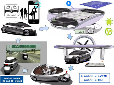

“Strap on wings to go up, snap on wheels to go horizontal”
Want to discuss the possibility of combining eVTOL and automobile? Go to one of the following meetings:

Prepare yourself for a meeting that will throw new light on ’Beyond UBER’ Ride & Flight hailing
and the sort of sleek, lightweight EV that is long overdue.
