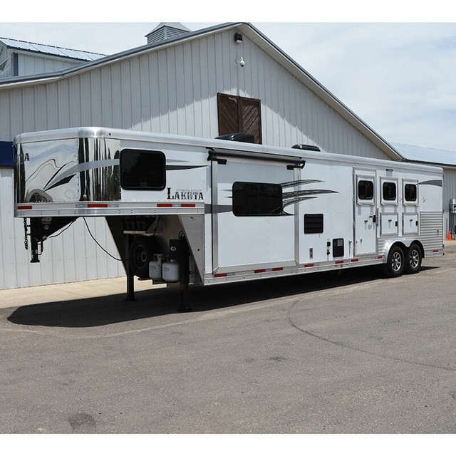

    oh man, this is such a good example of the wrong equipment for the wrong job.
    the cybertruck is really interesting to me, but I'm not going to sell my gooseneck just so I can justify one.
