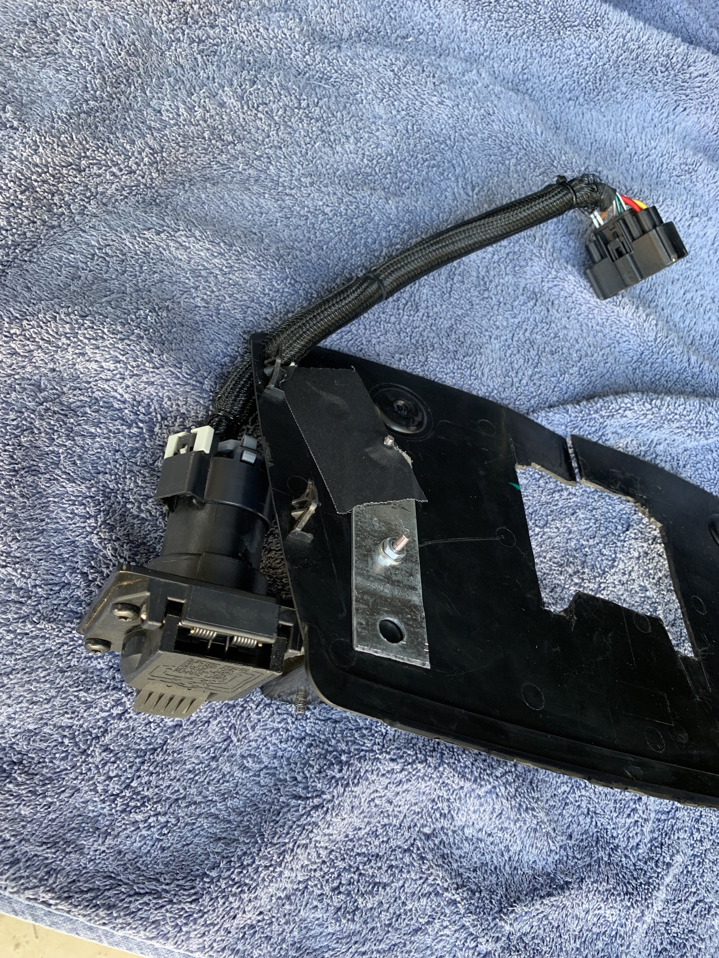

For the 7-pin adapter, made a little bracket to point the plug back in the direction they normally go, since the Draw-Tite has no provision for it. After it all came together realized I probably should have painted it black, will do so when it comes back apart to modify the wiring.

The other thing I did with it apart was paint the bracketfor the 7-pin black, and reinforce it a bit better on the other side of the panel.
Lower/underside of panel:
Upper side of panel:
