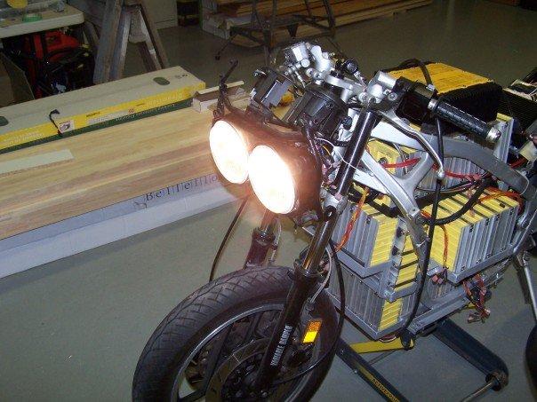

To have any chance of long term reliability with these batteries one has to provide a proper BMS (Battery Management System) that provides individual battery balancing functions and avoids over charging or over-discharging any of the individual batteries. If you just string them together in series and charge them as a group unit then you are likely to get cells out of balance and have short lifespan. I have also heard that the batteries need to be physically contained in some sort of rigid battery box. If you let them expand and contract it may also shorten their life.
Here was a prototype eBike with Thundersky LiFePo batteries just hanging off the chassis:
