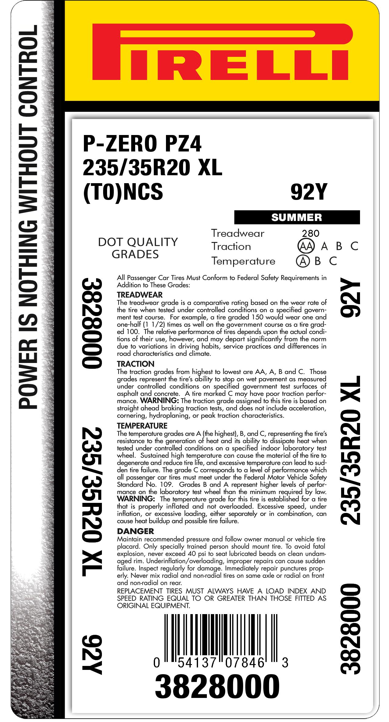

@BennyNielsen I think the M3P OEM PZ4 is labeled "Elect" but there are other PZ4 Elect with different specs. For example in the 235/35R20 stock M3P size Tire Rack shows 3 (!) different kinds of PZ4 Elect, for McLaren, Porsche (N1), and Tesla (T0). The Porsche version is listed as 220TW 88Y SL, while the McLaren and Tesla versions are both 280TW 92Y XL. Only the Tesla version is described as having "Noise Reduction Technology" - which I believe is the foam liner.Thank you for that. Is it also til Elect model of pirelli that is OEM for M3P? The Pirelli tire is with foam liner. Even in the 265/35R19. I only use my M3LR for a daily driver so i am looking for a tire with low rolling resistance and low noise. The Pirelli seems to give me that but I will take you answers into consideration before buying tires. Thanks again![]()

https://www.tirerack.com/tires/Tire...=P+Zero+(PZ4)&width=235/&ratio=35&diameter=20
https://www.pirelli.com/tires/en-us/car/catalog/product/new-p-zero-elect/235_35-r20
https://www.pirelli.com/ecolabels/web/us/3828000_US_P.jpg
The only 265/34R19 PZ4 I see is *not* a Tesla spec tire (not T0 or T1 or such), however it does have "NCS" on the label which I believe means foam liner. So I guess you're right, you can get that liner in 265/35R19, neat.
