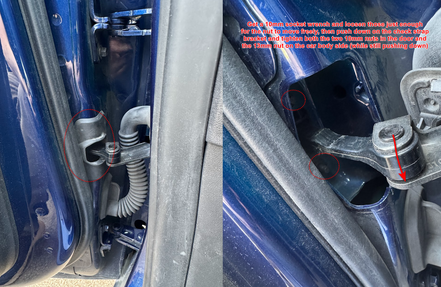

Thanks @marines310
I saw this video on youtube as well. I have a mobile tech coming out on Thursday. Will have them take a look at the screws. The tech in the SC mentioned that he did evaluate the nuts, and they were correctly torqued, but I don't believe he actually took the door panel off while I was waiting, so not sure if he did a full diagnostic.
Thanks @marines310
Yeah the clip I saw also had a similar situation where the actual problem was inside the door frame itself and not the exposed hinge you see here. A replaced hinge did initially fix the problem but eventually it came back in no time and the actual problem was then located inside the door. It's a trickier operation so I think the mechanics wouldn't automatically open up the door.
Could you try pinpointing to where the noise is coming from precisely?
Gotcha, I'm 80-90% confident it's coming from the general area of the check strap. Seems like it's a clicking noise coming inside of the door panel. To your point, it may be coming from inside the door, but from what I know the check strap can be replaced in one of 2 ways: there may be an option to just pop off the speaker and replace the check strap, and the 2nd option which is to remove the entire door panel to see if anything else is the root cause.
My gut is there may be something catching onto the check strap, but who knows? I just let the mobile tech work solo last time due to trying to give the guy some space, but I may just hang out there with him on Thursday and watch as he works. The last guy finished the whole process and was gone in 15 mins....I don't think he actually did any troubleshooting and just replaced the check strap and left.
