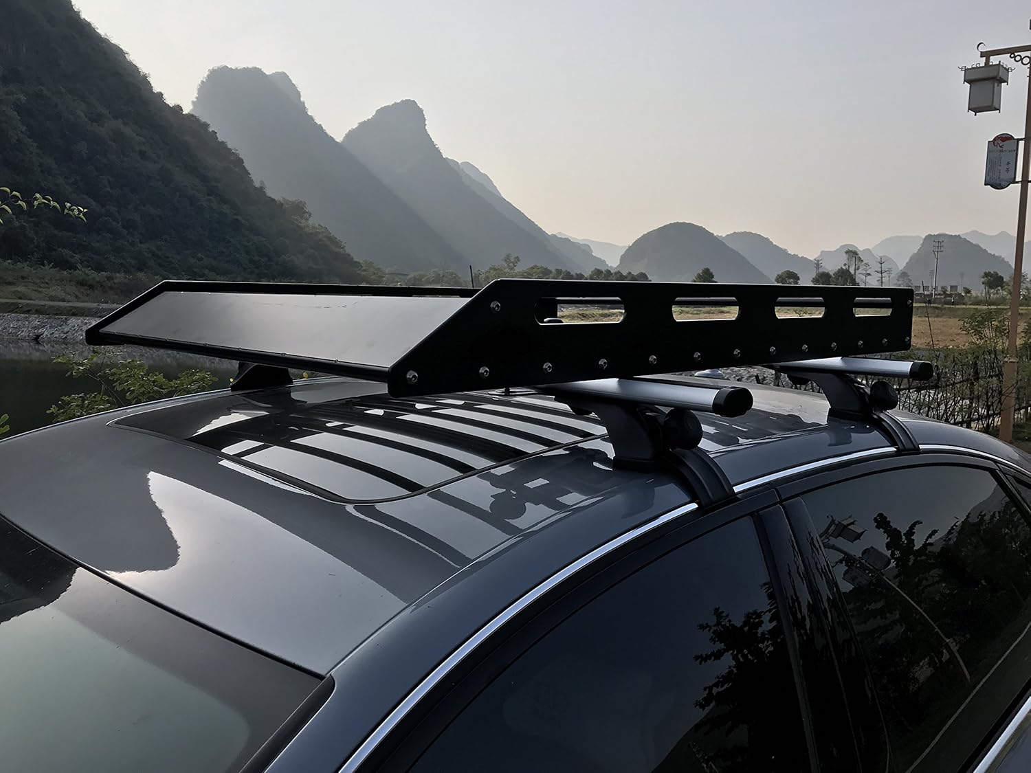

    I checked online and called Yakima in advance to confirm that their MegaWarrior and SkinnyWarrior baskets will fit their Tesla MY roof rack. I ordered the SkinnyWarrior, and it does NOT fit. When I sent photos in to Yakima they confirmed by email that I shouldn't use the basket. The problem is the feet for the Warrior baskets can only be set at certain spread increments and the MY rails are fixed at a 35" spread. They don't match up!
    The only cages that will work are those that have feet that are continuously adjustable along the lengthwise axis. So now I'm thinking the Thule Trail XT, but at $500 for the smaller size it's an expensive basket, although it looks really sharp.

    I recently noticed a car with a Thule basket and I took a picture of it as I was a little bit intrigued, and you are right it is quite nice looking.

    The Thule Trail XT (Med) finally arrived. I installed it and I think it looks great. The feet are continually adjustable so I had no problem accommodating them to the 35" spread of the roof rails. It's very easy to lift overhead and attach by myself. The cage is a little less functional than I would have hoped because the fancy thick aluminum sides make it impossible to attach hooks there. There are four hook holes on the outside of the inner longitudinal rails, but no place to attach a hook to the front or back of the rack. A simple tubular cage would be more functional, but I guess this one looks nice. :) I have yet to test how it affects my KWh/mi.
