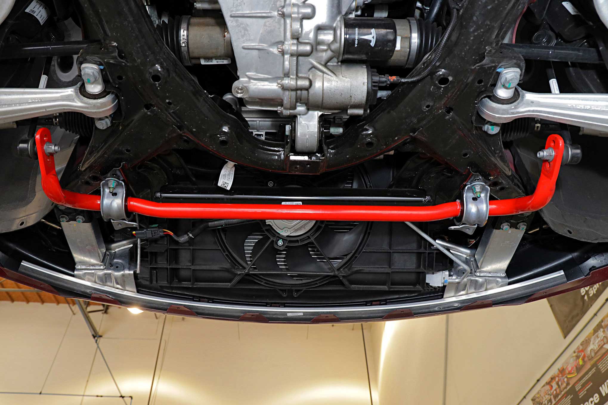

The Unplugged Performance front way bar, in the recommended "soft" setting, causes the sway bar end link to rub on the lower control arm, as seen here on my 2019 Model 3 Performance:
![IMG_20200212_095944.jpg IMG_20200212_095944.jpg](https://teslamotorsclub.com/tmc/data/attachments/496/496223-9f64ba60736d55695971ee7da43d8886.jpg)
Also reported by @webbah here Sway Bars, End Links, and Rear Control Arms Installation & Impression
So far UP says they haven't seen the issue: Sway Bars, End Links, and Rear Control Arms Installation & Impression
I've contacted them via email, will see what they say.
