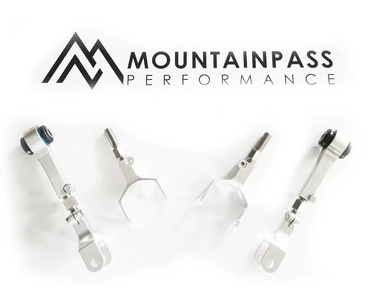

    Model 3 Rear Suspension Arms:
    The Model 3 uses rubber bushings in most links throughout the rear suspension. These rubber bushings are in place because they are cheaper than sealed bearings, and that do well enough for normal road driving. Once you start turning up the G's, the compliance in these bushings stack up, and the flex in the rear suspension you feel tricks your mind into thinking you are at the limit of the tire. Every bit of flex or movement between you and the tire is something that detracts from your connection to the road.
    Expensive performance vehicles come factory equipped with sealed bearings, because these links offer a direct connection between the tire and the driver. We have designed our arms using these same sealed bearings, while also making the arms adjustable.
    Normally, aftermarket suspension arms use a spherical rod end, because these are cheaper and easier to implement as there are already threads - all you need to do is build an adjuster sleeve and you have an adjustable arm.
    We felt having a sealed bearing was critical to producing a part that had both the longevity and durability of the OEM components. Exposed spherical bearings accumulate dirt/moisture/salt and tend to squeak, clunk and deteriorate over time (we tend to replace all exposed spherical bearings every couple of seasons on our racecars, sometimes more frequently). Using sealed OE bearings on aftermarket performance suspension arms isn't something I've seen done before, but we're sure this will become a trend as it is such a big improvement over exposed spherical bearings for road cars!
    Now, aside from better connection to the road while cornering, why do you need aftermarket suspension arms for your Model 3? The answer: to correct the camber and toe when you lower the car.
    The Model 3 has limited rear alignment adjustment range, and in order to correct the camber and toe from lowering, aftermarket arms are required (unless you hardly lower the car, or you want a very aggressive alignment).
    For most road cars that are lowered more than 0.75" or so, you'll want to be able to take out some rear camber to extend tire life and improve rolling resistance (all of our reading suggests that while additional negative camber decreases the tire contact patch with the road - the extra deflection and load on the inside sidewall actually makes rolling resistance worse).
    Our arms allow a ton of adjustment, and also feature lessons learned from Motorsport that your alignment shop is surely going to love. Using clamps rather than jam nuts, the alignment won't change when you lock down the suspension arms. Any professional race mechanic or alignment expert will know that locking down a jam-nut will extend the arm that little bit that will affect the toe slightly (it's less of an issue on a camber arm, admittedly).
    We've also used offset thread pitches rather than LH/RH threads, to offer very precise adjustment. Rather than 1/6 of a turn being 0.5mm of adjustment, an entire rotation of our adjuster will be 0.5mm of adjustment. This might not mean anything to you right now, but your alignment will be significantly more precise as the technician will be able to dial in the camber and toe exactly, and lock it down without anything changing.
    These are features that I designed personally into the arms because I was frustrated with how difficult aftermarket suspension arms were to adjust precisely.
    The arms are also designed to be as lightweight as possible. A number of iterations through FEA led us to this design, and the center is drilled almost entirely through - well beyond the threads. The OE bearing is by far the heaviest part!
    The photos are of our prototype set, so we didn't have them anodized. Production arms will be anodized - color yet to be determined. They will either be Blue or Black, we're open to your input on that!

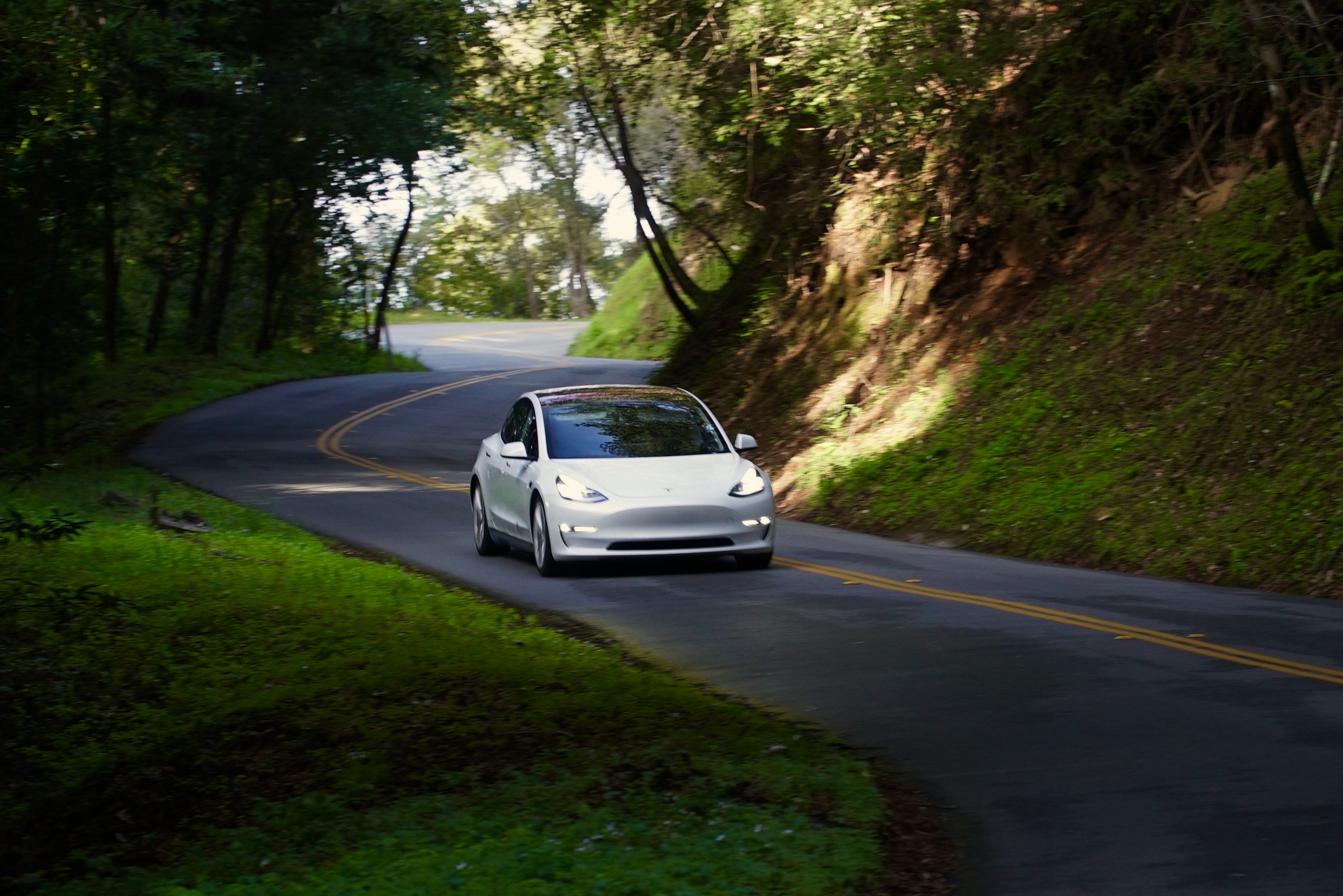

    Here's a quick photo of our Model 3 test car with our coilovers and suspension arms installed. What an incredible car to drive (stock, and especially now!).
    We are instrumenting damper travel directly with a Motec M150 ECU/Logger, and it has really allowed us to get the spring rates and damper valving matched for incredible ride quality even at very low ride heights. This thing is ridiculous through the mountain roads around here...
    We'll be posting some specific details on the data analysis and instrumentation that we're doing

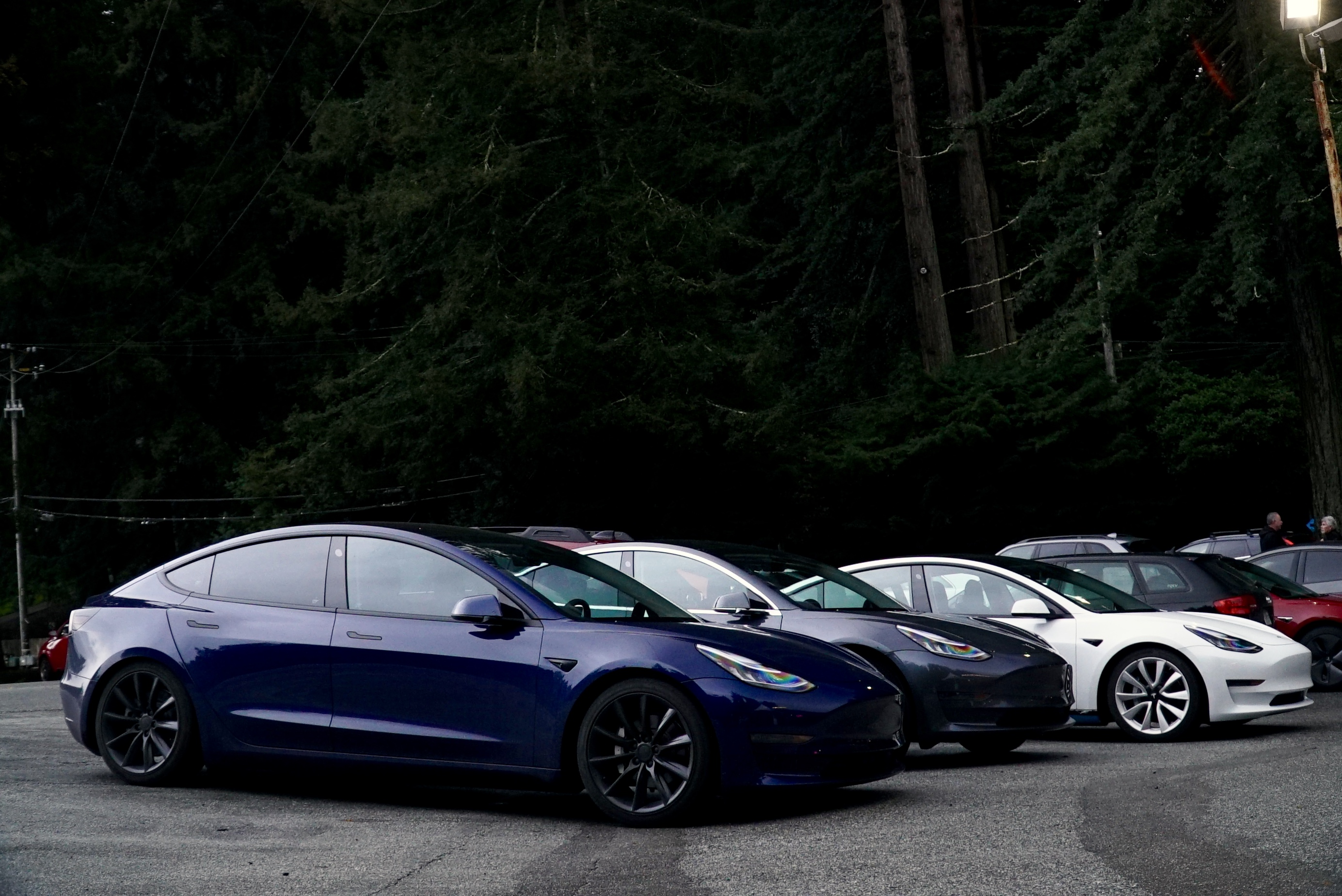

    Our meetup at Alice's last night was a great time. It was a pleasure to meet Model 3 owners that were passionate about performance and excited to see upgrades developed to enhance the performance nature that is bred into these cars. We took almost everyone out for a ride and the reactions were better than we could have hoped for! We shot a quick video as well so that will be posted up in the near future.
    You can read all about it here: California Trip 2 – Tesla Meetup At Alice’s Restaurant

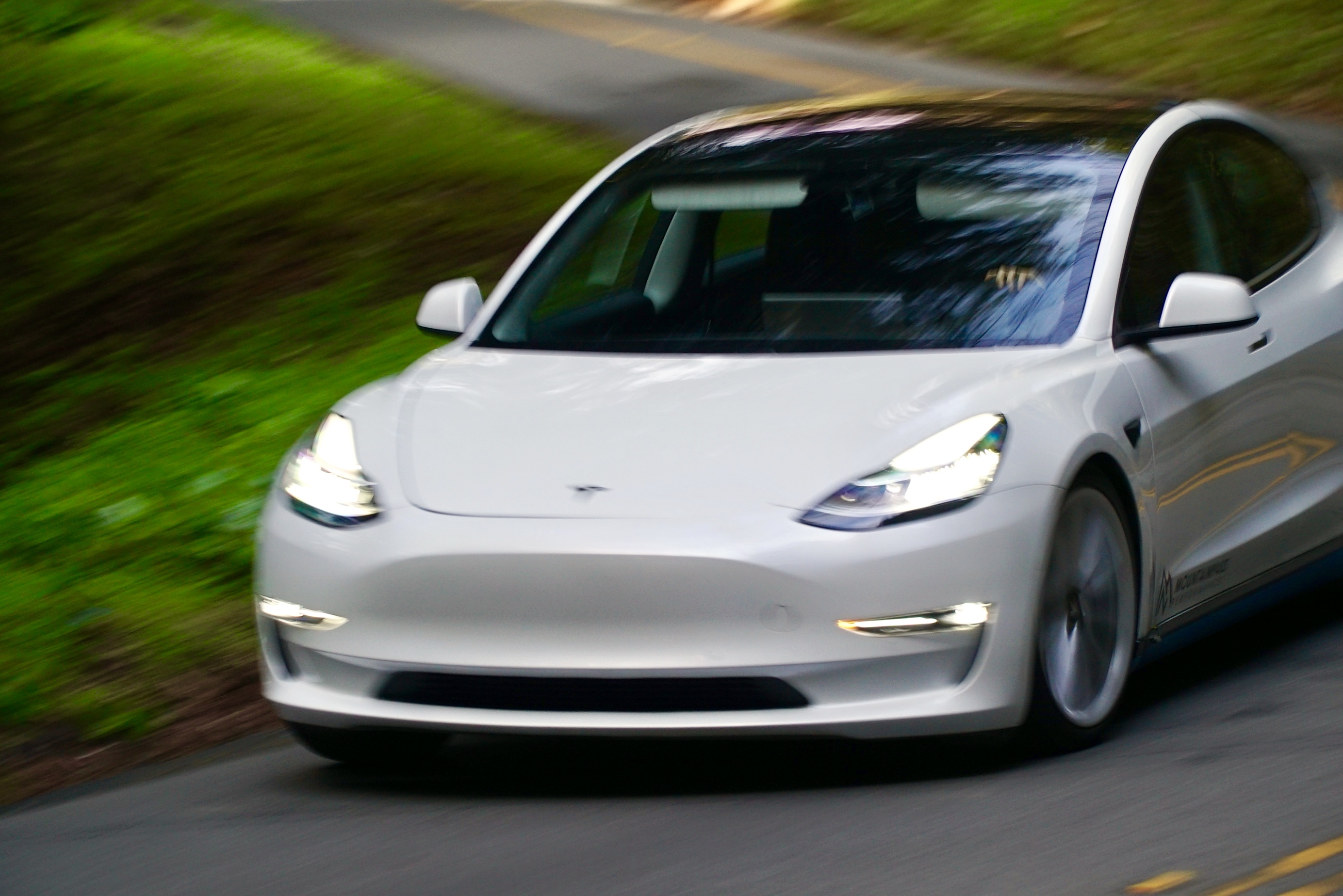

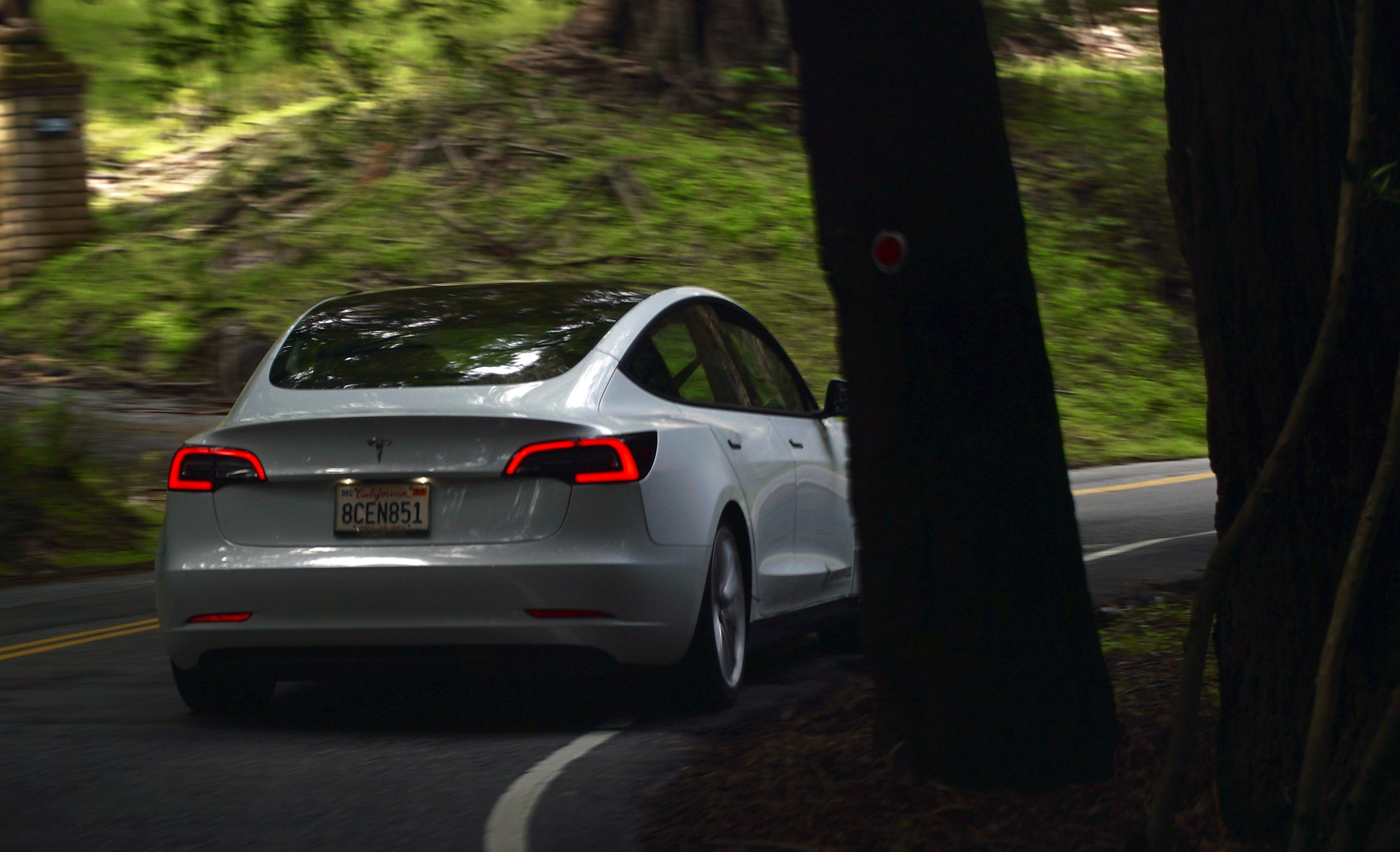

    Here are a few more photos of our development trip so far:
