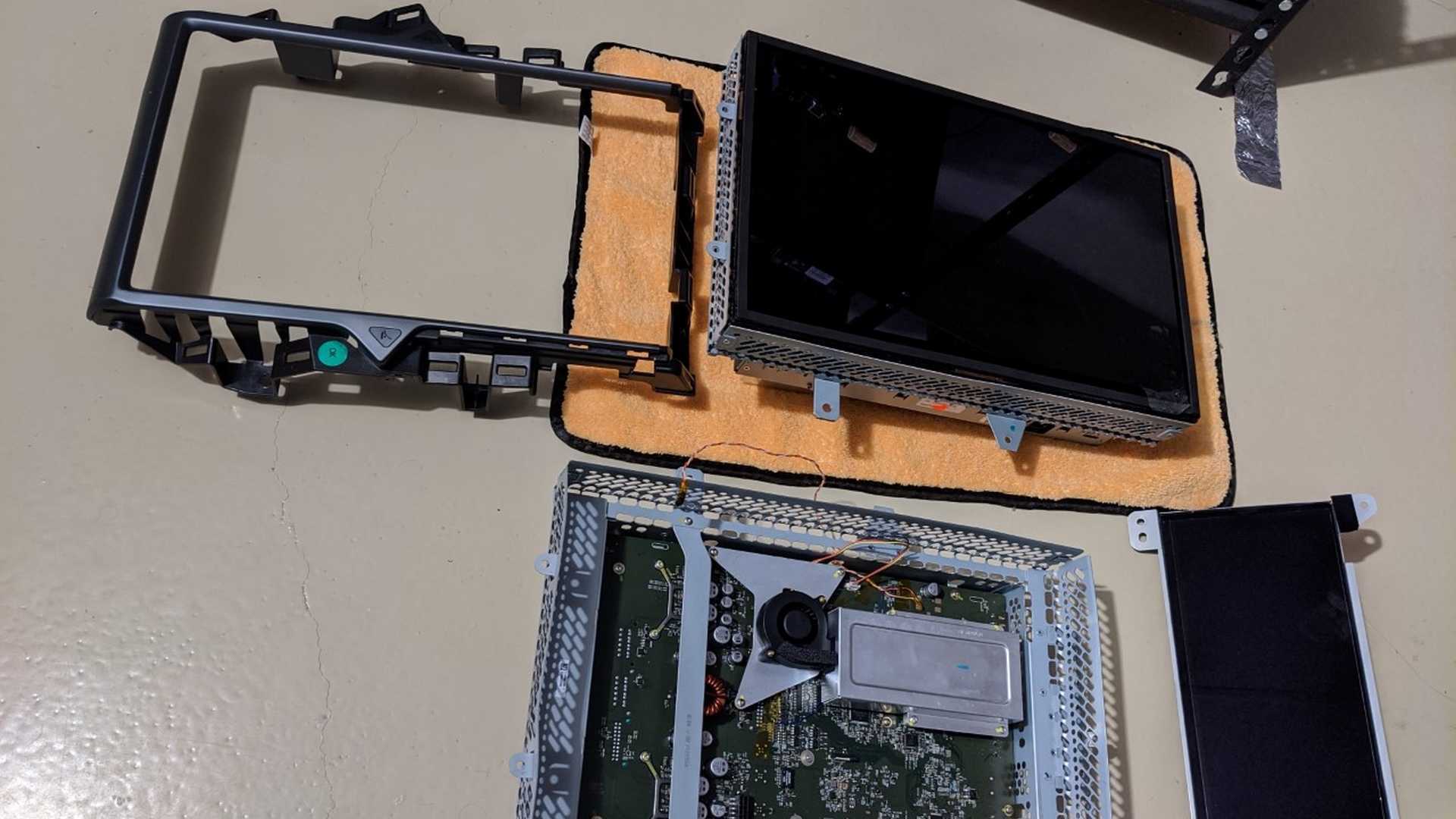

MCU1 display surgery finished. Fixed for now :) Update for future attempts
Patient Status
Overview
The fix is basically epoxy air tight entombment to seal the plasma layer so no air gets sucked back in when thermal cycling plasma. I'd imagine this fix is only possible for early stage leaks. The plasma is nearly impossible to clean off and once it leaks too far, epoxy won't have enough clean surfaces to bond to provide an airtight seal.
Needles
30 gauge 1 inch needle. None at 6 local pharmacies and clinics. Went to a compound pharmacy (pharmacy where they can actually custom mix drugs per prescription beyond standard made drugs) and scored 8 ($0.25 each). Ended up using 4.
Epoxy
Used JB-Weld Pro. 5min setup, 1 hr cure. Gorilla epoxy reviews weren't great. So went with good old JB Weld.
ClearWeld Pro Size | J-B Weld
Air Bubble Extraction
This is a bit of an art after some practice. Here are some tips
- Brand new needle will work well first use. Bubble/air_strip will shrink immediately when plunger is pulled. On 2nd use, usually will be dealing with some clogging.
- To combat clogging. Here are some tips 1) get more needles and single use 2) soak needle in cleaner (used 99% Iso alcohol), pull plunger back, insert needle and jet out the alcohol. Do this a couple of times. 3) rotate needle 180 degrees after insertion into plasma bubble, this can sometimes unclog the tip clogged during insertion
- When bubble becomes small, I found holding vaccum in the plunger while pulling out the needle, often the air just suck through the needle channel as it exits ending up with a perfect bubble free seal. Quite satisfying haha.
Anyhow a bit of an art after some practice.
Towards the end, some bubbles were too small to do more extraction (might introduce some air during poking) and some bubbles were lower towards the LCD where needle can't get at it. I left these alone. You see those in the after pics. Not too objectionable.
Seal
First find the air leak source along the plasma seam. Plasma at the leak site is likely softer/gooeyer than places that hasn't leaked. Mine was under the flex cable near the glove compartment switch. Plasma is difficult to clean off and near a fragile flex cable connection, I chose to entomb the whole area (cable connections and all) with epoxy to create an air tight seal.
Go around the perimeter and inspect the plasma leak. Epoxy need clean surface to grab onto so anywhere plasma has oozed out a little, scrape off some plasma to reveal clean bonding surfaces.
Even if no leak under the 4 flex cables, still need to unfold them back to apply epoxy to seal the plasma seam underneath. Not too fragile but need to be careful and gentle. Cable bonds to glass (similar to LCD screen edge bond cable/tape)
The tiny 1 line flex cable over the both side of the 1/8" glass substrate, I just entombed this whole area in epoxy.
Someone said to remove the black tape around the perimeter. Impossible in my attempt picking at it with an exacto knife. Almost like it was baked on there.
Longivity
So will it hold? I'm guessing likely. When I extracted air near the leak source, bubble/strips soon form again with air entering again. After epoxy, no bubble/strip formed. So its air tight for the moment. Will the epoxy seal survive future thermal cycling? will plasma further liquidify and increase volume? Don't really know. Epoxyed perimeter at least gives the 2 layers of glass above plasma some structural rigidity rest of the display body to combat gravity pull with the vertical LCD orientation.
Reassembly tips
Top 2 bolts holding MCU1 to dash chassis really easy to cross thread with wrong angle. Easily too low of an angle. Bolts point more towards the roof than likely vantage point while seated.
Will report back if not holding air tight seal.

Unfortunately the fix didn't hold after a couple of warmer days in the sun. Looks like air leak developed in the touch screen tape connection at the top edge. Probably the more complex surface area to entomb with epoxy.
Perhaps I didn't entomb with enough epoxy and seal off all air channel. Perhaps greater thermal expansion of liquified plasma created new air gaps. In any case, appears not a reliable solution for air bubbles but perhaps can prevent goo spillage (will check later with some time lapsed)
Also learned the 17" LG industrial display is standard (can purchase online) However, Tesla customized and added touch screen which probably explain why it didn't look as integrated as one might expect from a standard LG product. This might explain the sequence of problems with this touch screen from the start (bubbles from liquifying plasma on early units, yellowing borders on later units)
Another update a year+ later. Car parked in garage in temperate Seattle climate.
Leak has become much worse. UV+heat probably changes the properly of the goo in the screen. And looking at air bubbled area, there is no visual difference. So the claim of viewing angle application of this goo is probably false design decision.
Leak is from the MCU's bottom flex attachment to the underside of the top glass. I didn't apply any epoxy there originally (just cautious) but now realize probably safe to do so. Regardless, can't seal underneath the flex cable and there are surely exit channels through the edge of the LCD assembly below as well. Doubtful can really seal this thing. Used denatured alcohol to remove the leaky mess. Works pretty well.
Going to order a replacement and will see if actually possible to separate the touch screen layer and clean off the goo on this one.
